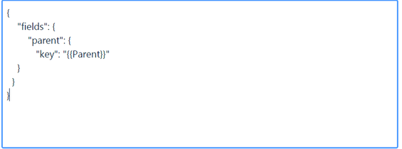

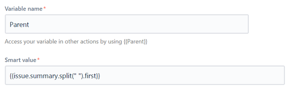

I have created an automation rule that triggers when an issue is created with a specific issue type. I am then creating a variable by using the issue.summary and then splitting on a space to use the first part of the summary which will be in the format "SD-123 - title" where SD-123 is the Jira issue key of the parent task I want to link the sub task to. This will give me a variable named Parent that will contain "SD-123" for example.
CreateVariable.PNGI am then using the "Edit Issue" action to edit the issue type to a sub task and then trying to set the parent using the additional field JSON shown below, which uses the variable created above:
When the automation rule is triggered it completes successfully, without any issues, amending the issue to a sub task as required but the sub tasks parent doesn't appear and the sub task ends up without a parent.
Is there something I am missing when setting the parent in the additional field JSON shown above or is it not possible to set the parent of a sub task in this way and therefore my required outcome not achievable?

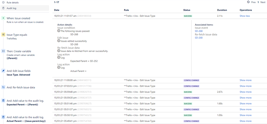

For some context, would you please post an image of your entire rule?  Thanks!
Is this for a classic or a NextGen project?
Next, if you log the {{Parent}} to the audit log, what do you see?

Thanks for your response.
Please see image below of entire rule with the logging shown in the audit log.
I can confirm this is a classic project.

Bill Sheboy
January 19, 2021
Thanks, Dan.
If you are trying to edit the parent for a sub-task, it does not appear to be possible yet.  I found that looking at the advanced JSON help and using a REST API call to gather the editmeta data for a sub-task.
https://support.atlassian.com/jira-software-cloud/docs/advanced-field-editing-json/
https://developer.atlassian.com/cloud/jira/platform/rest/v3/api-group-issues/#api-rest-api-3-issue-issueidorkey-editmeta-get
