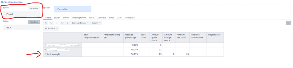

I would like to display values in the row of a project but I don't know how to address the project row. I use Project as pages but I assume it is still a dimension? Thanks in advance.

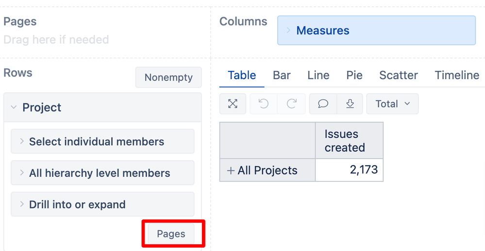

I recommend removing the Issue dimension from Rows and dragging the Project dimension to your Rows. Once you have added Project dimension to your Rows, enable the "Pages" button to also add Project dimension to Pages (to allow report filtering by Projects).
You might find the documentation here https://docs.eazybi.com/eazybi/analyze-and-visualize/create-reports#Createreports-Pagedimensions useful to learn about Page dimensions.

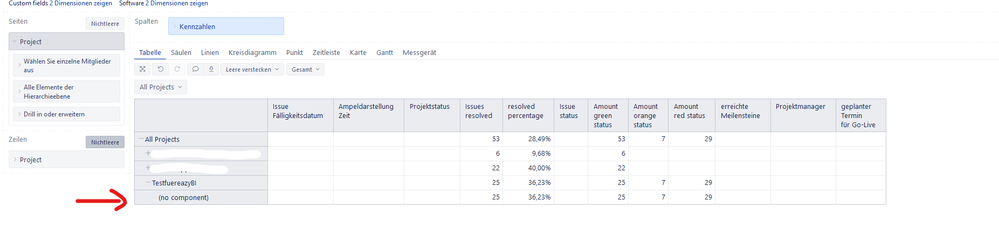

Thanks a lot Elita. Another question. How to get the issues of each project as dropdown? Marked in the picture belowScreenshot 2023-04-06 112357.png

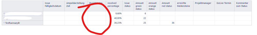

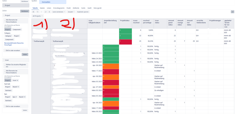

Im close to my desired state as you can see in the picture below. But I don´t know how to remove the 1) column which belongs to dimension project on the left. Otherwise the 1) column is necessary as dimension for my calculated members. Screenshot 2023-04-06 115610.png

Hi @Onur Cevik
​Thank you for following up and for sending the screenshots!
​In that case, I suggest moving Issues back to Rows and selecting Project level (that will allow you to expand to the issue level as well).
​Since you have some project-related formulas in your report, you could get the required details with the following calculated measure (the example below is for returning the Projektstatus. Similarly, you could get other properties of the project by changing the last part in the formula and replacing "Projektstatus" with necessary project properties.
[Project].[Project].GetMemberByKey
([Issue].CurrentHierarchyMember.Get('Project key'))
.Get('Projektstatus')

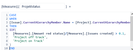

Thanks for helping. I have tried it but it doens´t work. The column Projektstatus depends to the column Ampeldarstellung Zeit. Another calculated measures counts every green, orange and red cells in the column Ampeldarstellung Zeit and Projektstatus displays 'Project off track' if amount red status divided by amount issues created if bigger than 0.1 else Project on track. When dimension Project disappears the status in row of project name disappears as well. I hope you can follow me. Pictures attached. Screenshot 2023-04-13 104146.pngScreenshot 2023-04-13 104709.png
Onur Cevik
April 13, 2023

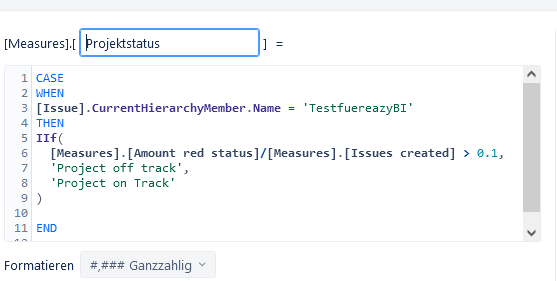

Hey @Elita Kalāne - eazyBI Support
Otherwise it could work if I change the code. In the post above you can see in line three, that the issue name has to match with the project name. If I replace the code after the equal sign with the name of the project my disered configuration works. How to code after the equal sign to get automatically the project name? In the picture below you can see if I write the name of the project the issue above works. Screenshot 2023-04-13 105704.png
