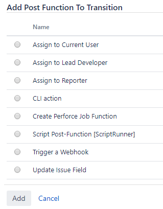

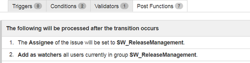

I saw in another thread that it is possible to add watchers using post function on issue transition.
But I don't see such option in our JIRA 8.4 instance.
Is it possible to do without a plugin?
This is what they see:
Vs. what I see:
Peter DeWitt
November 11, 2019
@Daniel Brvnišťan , to answer your specific question, No. You can't add Watchers in naked Jira. You will need to use an app to do this. I see from your screen shot you have scriptrunner so this should be pretty easy to do.

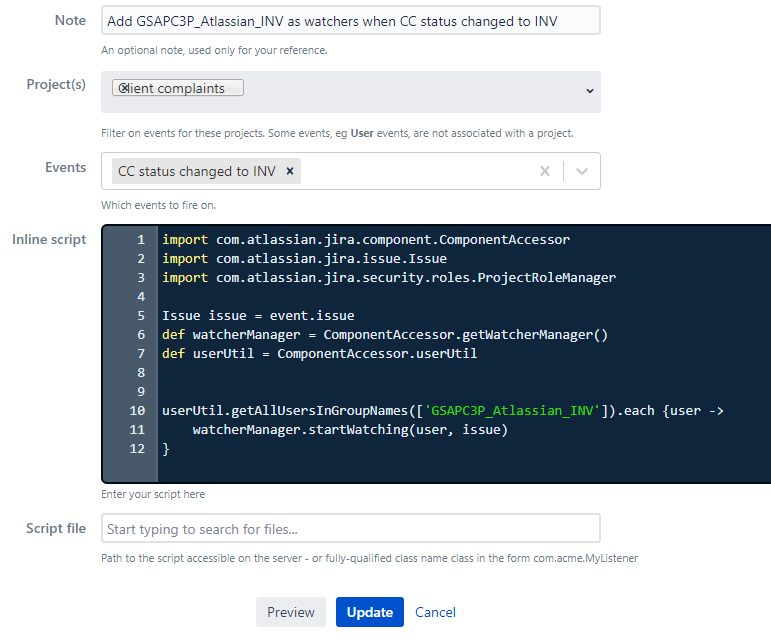

Thanks for the tip - I looked at that page, but I am trying to add a specific group when a specific transition happens. I created the event and now I am creating the listener - if I get stuck I will post a new question, and I bet you will have a solution :)

Daniel Brvnišťan
November 20, 2019
Hi Kristian,
Sorry for the delay in reply.
Here is the listener, logs are coming.
When I pause the listener, it still happens on those issues where the listener once ran, but not on any new issues.
listener.PNGThanks,
Daniel

I can confirm the listener shown in your attached screenshot is only configured to fire on the CC status changed to INV event which means any workflow in your instance configured to fire the event will trigger this listiner.
Can I ask if you completetly delete the listener does the behaviour still occur and have you checked as suggested previously if any other script listeners or scripts are configured that can modify the watcher's field on your instance.
