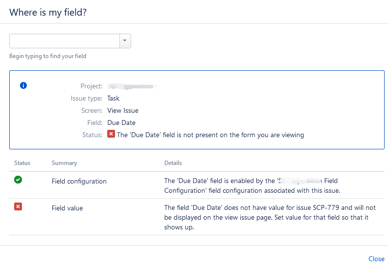

I tried using "Adaptavist ScriptRunner for JIRA" to do a scheduled job but failed.
Maybe the "Due Date" field cannot be added to issues in this way. Because this field doesn't have value in these issues, they aren't able to show the value of the field.
I need to add this field and give it value.
BTW, the "Due Date" field is on the view screen.

You probably need to add the Due Date to the Edit screen and then try running it.
rayion
February 9, 2021
Thank you for your reply.
Actually, I added the Due Date to the Edit screen. But running failed.
It's on the Create/View/Edit screen.

After running the scheduled job, I checked the issues but no the "Due Date" field.
Maybe I should recheck my scheduled job.
