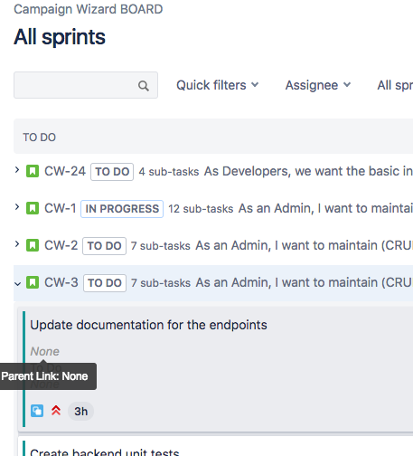

I know that there are settings to do change the card layout through Board => Board Settings => Card Layout. The problem is that there is no option to add the parent user story. There is 'Parent Link' which shows NONE on the card, for the tasks that does have a parent.

Vinicius Kienen
August 16, 2018
Hi Jack, first of all, thank you for the virtually immediate response - I am so used to bad customer support that I must say I am a bit surprised by the response time here :)
The behaviour you mention is the one I expect as well, but it is not what is actually happening. I hope I can make it crystal clear with the screenshot down here.
Note that the subtask does not show its parent CW-3 (user story) as expected.

Jack Brickey
August 16, 2018
@Vinicius Kienen, so it appears Parent Link is associated w/ Portfolio. See this article Showing Portfolio custom fields in Jira software. So unless you are using Portfolio it will not work. FWIW, i did find it odd that the field exists in Jira and I can even write a JQL like parentlink is no EMPTY but when I display that field in my resulting query there are not values. :-)
What I suggest you look into is creating a custom field for your sub-task and copying the parent issue into that field when the sub-task is created. You can do this by setting up the a post function (Copy Value from Other Field) to copy the issuekey from the parent to the sub-task. I believe this would work.

Vinicius Kienen
August 16, 2018
You're a legend :D btw just realised you're not support, but community :P :P guess you can see im new here.
Thank you, we are using Portfolio but still does not work well. I've discovered this 'Copy Value from Other Field' thing and it actually worked well.
Not as straightforward as one would expect, but at least is done.
