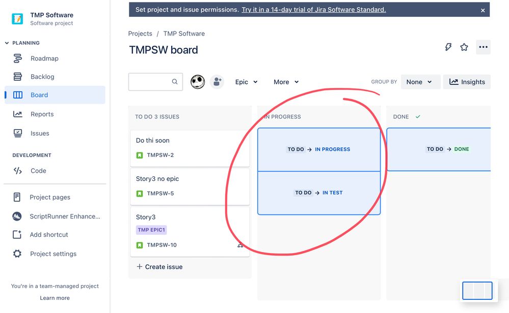

is it possible that this project is a Team Managed project? Please check lower left corner. You will not see Board settings in TMP. However, if you've map multiple statuses to a single column, then you should see the two (or more) statuses delineated when you try to drag and drop a card into it as illustrated below. It behaves similarly in CMP projects.

Thanks, yeah can see the statuses when go to drag and drop but when just looking at the board,  need to know which tickets are in which status. Hence why I need the status on the card itself. I assume this isnt available in the version we have and multiple columns is the only answer? :(

Currently, in TMP software projects, yes the only option is to have separate columns. This may change in time. Here is an open suggestion labeled Future Consideration -  JSWCLOUD-17336 Ability to customize the fields shown on cards in team-managed projects (backlog + board)

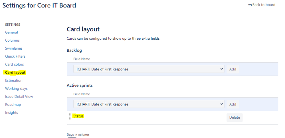

For Company Managed Project, try the following:
Click upper-right 3 dots menu and select "Configure Board"
Select "Card Layout" in there and add or remove field you desire.
In the "Active Sprint" section, add "Status".
Note: you can select 3 fields max
So, for ex: I've added:   Story Points, Labels, Status

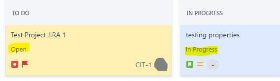

Hi @jo_astley ,
You can navigate to board settings > card layout and add status.
After adding, the issue cards on the board should appear something like this:
The provided screenshots are from a scrum board on cloud deployment. It should work for Kanban too :)
