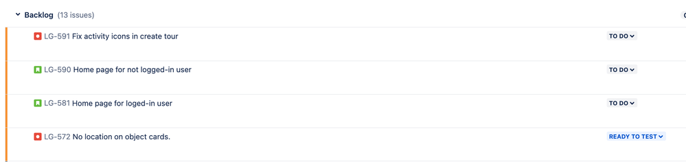

In the Scrum board, you do not map a status to the backlog. All issues, which are not in a sprint, go to the Backlog
So if a issue has the status of "Backlog" and is not in the active sprints in the backlog tab u will be able to see the issue with the status.
Refer below screenshot:
Secondly check if u have "Backlog" status in your project.
Note: Backlog is a place where u groom the issues to add it to the sprint
Backlog "status" is another step in your workflow.
