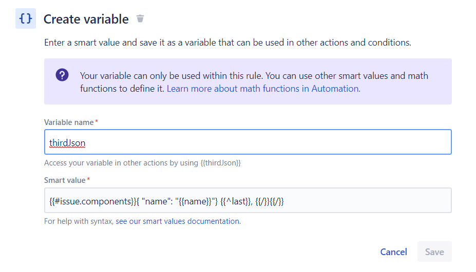

Timo Vertanen
August 11, 2022
Hi @manas Sahoo and @Bill Sheboy  and thanks for advices!
I'm trying the same as in this case but I got stuck in this:
"But it fails if the jira has blank components, it works if the jira had components already. What is the best way to make it work for both scenarios ?
I applied 2 branches and used a condition to use the above logic if components is already blank for the issue and that has worked well"
This is working for me too when there is already some component in the issue, but not when there isn't any components. Error is the same:
Error while parsing additional fields. Not valid JSON.
So, can you give me an example for this: "I applied 2 branches and used a condition to use the above logic if components is already blank for the issue and that has worked well"
I do have 2 branches and 2 more variables which are made almost like the 2 first variables but with different names and reference to name thirdJson:
{{#issue.components}}{ "name": "{{name}}"} {{^last}}, {{/}}{{/}}
{{thirdJson}} , { "name": "{{ "Rollout_Portugal" }}"}
 what are the differences in those 2 branch rules? What I'm doing wrong?
Best regards,
Timo

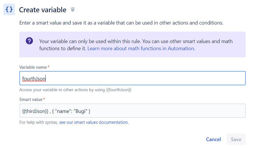

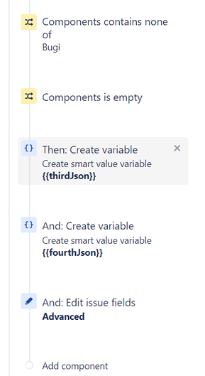

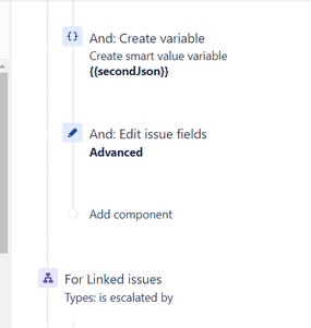

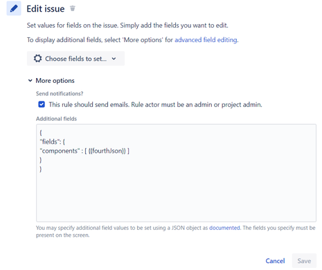

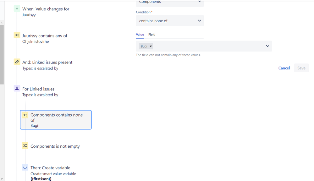

Timo Vertanen
August 11, 2022
Hi @Bill Sheboy
Hope these images helps:
Bill Sheboy
August 12, 2022
Hi @Timo Vertanen
First a suggestion: please consider using one of the free browser addons (or a screen-capture tool) to capture a scrolling browser window.  That will help to capture your entire rule in one image, making it easier to see what is happening.
Next, your use case is different from the original one in this post.  You are using branches on multiple issues, and as a result the processing occurs in parallel and asynchronously...often leading to unpredictable results for edits like you are trying.
Before we proceed, would you please explain the problem you are trying to solve.  Knowing that will help determine how/if the problem can be solved with an automation rule.
Thanks,
Bill
Timo Vertanen
August 14, 2022
Hi @Bill Sheboy
In my case there are project A and project B. Issue is created in project A and in some cases it creates a linked issue to project B.
When user adds (editing or resolving issue) in project B, the value "Ohjelmistovirhe" to a custom field "juurisyy" (Select List (Multiple choices)), then it should automatically add component "Bugi" to linked issue in project A.
I assumed that this automation rule would work for me, but only works when there is already some else component in the issue in project A.
Bill Sheboy
August 15, 2022
Thanks for that information.  For your use case, there are a couple of approaches:
  • Conditionally process the components: use an if/else condition in order to handle the cases of "none" or "some" initial component values.  The different paths will lead to different actions for the additions later.
  • Add a "placeholder" component: early in the rule, always add a placeholder component of a known value.  Continue to process as you existing rule does.  At the end of the rule, remove the placeholder value.  Please note, this approach will not work if you are adding components within a branch.
