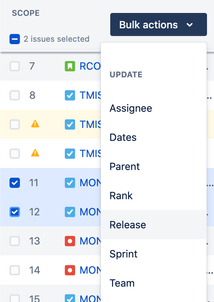

Sure! In your plan, check the tick boxes in front of the issues you want to update. As soon as you select more than 1, a Bulk update button will appear. Click it and select Release from the dropdown:
After doing so, click Review changes in the top right corner and save your changes to Jira (all your changes in an advanced roadmaps plan are draft changes until you push them through to your Jira issues).
One or two small remarks:
  • since releases are specific to a Jira project, it's best to make sure you only select issues from the same project;
  • make sure the release you want to assign issues to is available in your plan.

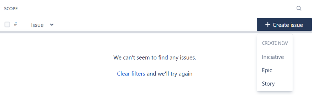

I am actually interested on learning how to add up Issues on a release version through Advanced Roadmaps only. In your last reply, you explained how to updated releases by editing Issues that are already set up on the version. I haven't noticed features on Advanced Roadmaps that enable new issues' picking from the respective project, only a button for Issue creation.create.png

As your screenshot shows: you don't have any issues in your screen. So you can't select any (obviously).
I suspect you are aware that Advanced Roadmaps is a view on issues in Jira and has additional features to work with them, right?

As I previously stated, my team and I have decided against using Backlog view in our Jira project board, so I am mapping alternative approaches to create versions. Formerly in this post, you drew my attention to the fact that I could add Issues in bulk to Releases using Advanced Roadmaps. Since then, I've been attempting to figure it out but so far all I've found is that we are unable to directly add Issues to a version using Advanced Roadmaps;
As I tried to demonstrate before with that screenshot, it looks that using Advanced Roadmaps, we can only add NEW Issues directly to a version as well as EDIT Issues that have already been added, is that correct?
