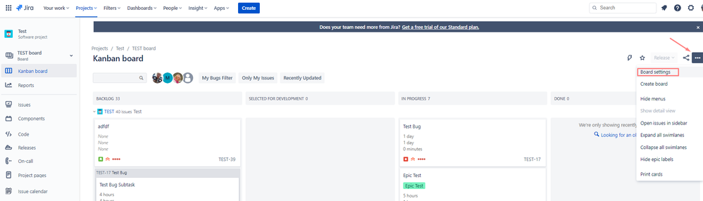

If you do not want to modify the filter on the board, you can include the filter you have created as a quickfilter on the Kanban board as follows
First you have to access the board settings and select quickfilters:

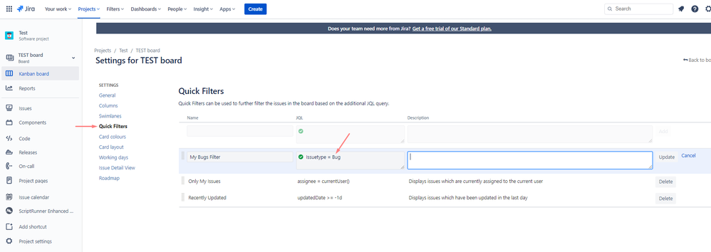

You include the JQL of the filter you need to make:

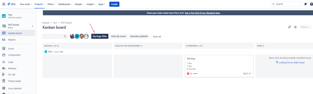

And you will have the issues that correspond to the filter by clicking on the button that appears at the top of the board:
