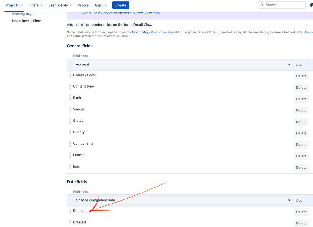

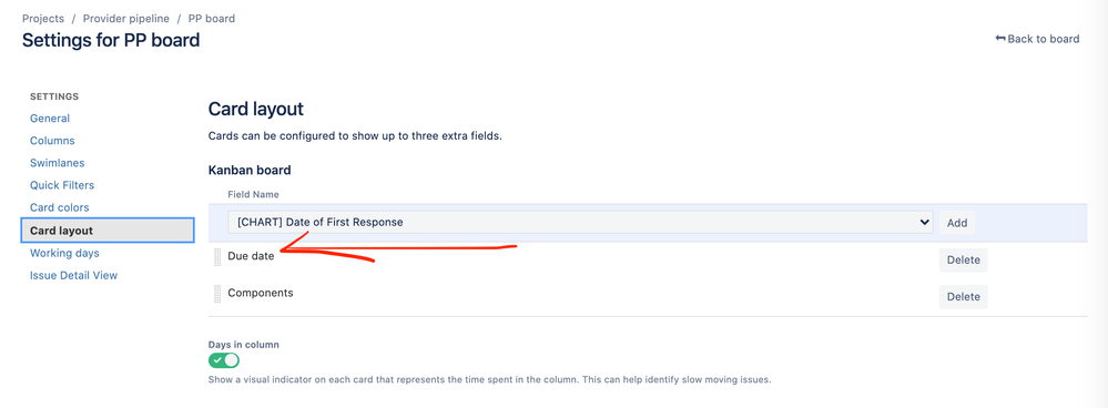

From boar settings, I added due date button in card layout and issue detail view but this button has not appeared on the card :((
Can anyone help?
Screen Shot 2020-08-14 at 16.18.26.pngScreen Shot 2020-08-14 at 16.19.29.png

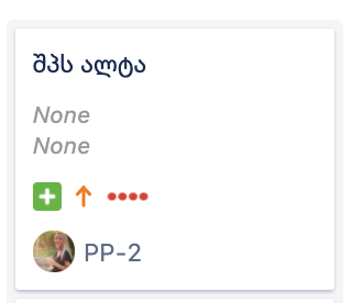

Can you share a screen shot of the board with a card on the board?

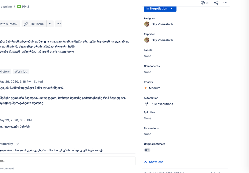

here are the screenshot:Screen Shot 2020-08-14 at 16.31.13.pngScreen Shot 2020-08-14 at 16.32.56.png

So it looks like the Due Date field might not actually be on the screen. You can add a field to the Detail Issue View on the board even though the field is not on the screen itself.
If you go to project settings then summary then screens, you should be able to find the screen that project uses. Then edit the screen to add the Due Date field.
