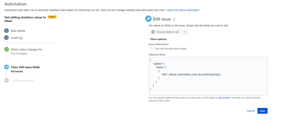

I am trying to copy the values of a checkbox (multi-select) to labels whenever a field value is changed for that field called "Test Checkbox". This is not a set or fields operation since this custom field is on a transition screen and can be sent back and forth (thus adding distinct values through the transition). On any pass forward through the transition, I'd like to add any new value. Not remove any past values to labels.
I've attempted to use smart values for the 'values to add' by following the guidance I've seen in other posts here like using list.join. That does not seem to work in Cloud and I'm unable to replicate it in Server.
I'm left with the additional fields Json response which I think is the right move, but am unable to figure out how to add any number of checkbox values at the same time (adding to the current labels array). Could someone help me understand the adjustment I need to make? (Been consulting this doc)

Every label you add has to be in a separate... "add object", so just expanding the list with .asJsonStringArray doesn't work, because I think you'd end up with:
"add": ["all", "of", "the", "labels"]
So I ended up having to use Automation's list iterator operator (#) to go through each checkbox and put it into the expected format:
  "update": {
    "labels": [
      {{#issue.Checkboxes}}{"add": "{{.}}"}{{^last}},{{/}}{{/}}
This then should expand to:
  "update": {
    "labels": [
      {"add": "all"},{"add": "of"},{"add": "the"},{"add": "labels"}
Which worked in my testing.
