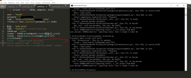

Teja
May 21, 2021
Hi @Prince Nyeche - ELFAPP
Here is my email address tejusn5@gmail.com
And the print of this code is
fields = field.search_field(name).get("id")
SS:
Thanks

File "C:\Python\Python38-32\lib\json\decoder.py", line 355, in raw_decode
raise JSONDecodeError("Expecting value", s, err.value) from None
json.decoder.JSONDecodeError: Expecting value: line 1 column 1 (char 0)
May 21, 2021
@Teja  Please hide any credentials or remove the image you just posted.
