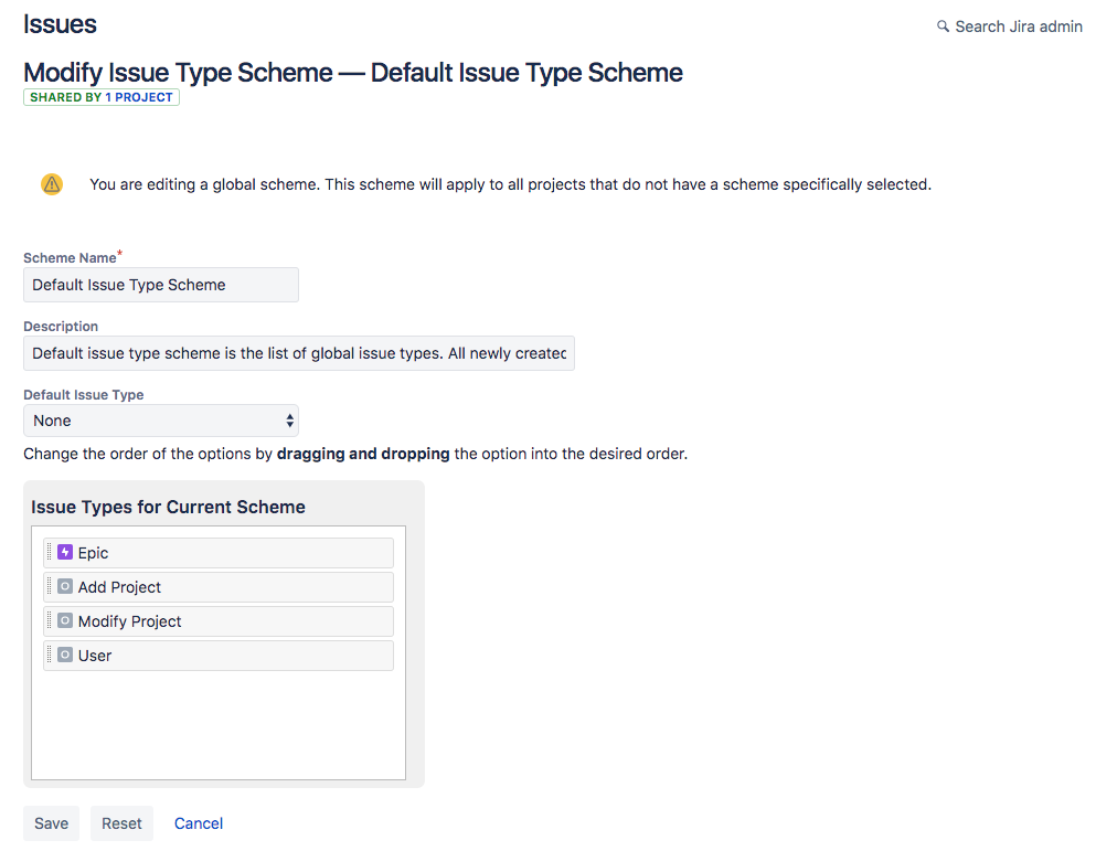

I'm having the same issue. I don't see an option to add issue types back to the global default Issue Type Scheme.

January 19, 2016
That is the problem, when editing the default scheme I don't have the option to drag any types. Only shows one column "Issue Types for Current Scheme".

Volkmar Schulz
January 27, 2016
It looks like this:
