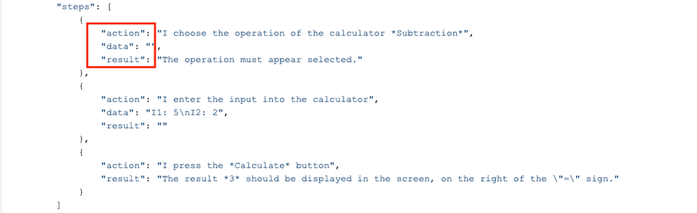

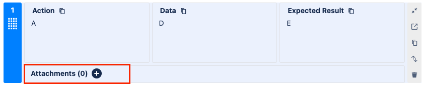

Hi team,
https://docs.getxray.app/display/XRAYCLOUD/Importing+Tests+-+REST+v2
Document just mentions to how to upload fields action, data, result to each test step in Test. How about with field "attachment" in each test step, Do you support this?Screen Shot 2021-07-12 at 10.14.23.pngScreen Shot 2021-07-12 at 10.15.54.png How to add an attachment/picture to each Test Step with XRAY REST API (XRAY CLOUD)?
Thanks,
Hoi

Hi @Hoi Tran
You need to use GraphQL (https://docs.getxray.app/display/XRAYCLOUD/GraphQL+API) and the mutation  updateTestStep (https://xray.cloud.xpand-it.com/doc/graphql/updateteststep.doc.html).
As an input, you have the object UpdateStepInput where you can set the Attachment.
Any additional questions, please get in touch with Xray Support (http://xraysupport.xpand-it.com); we would gladly assist you.

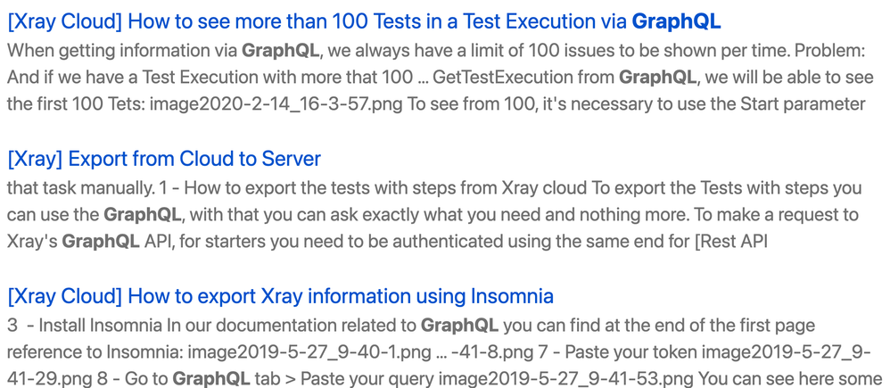

Hoi Tran
July 30, 2021
@Rogério Paiva - Xray Xporter Great! That what I am looking for. Thanks so much.
Do you have any examples for that, eg. for authentication like REST API?
I referred your link: http://xraysupport.xpand-it.com
but just see:
Do I need to raise a question to that page?
Thanks,
Hoi
