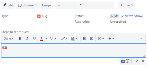

It looks like you've done the right configuration and I've just tested it myself on Cloud - it is still working:

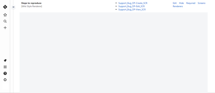

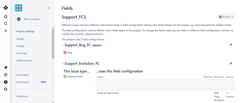

So I guess there is something missing in your configuration! Could you please go to your project settings > Fields > expand the field configuration associated to the Improvement issue type and share a screenshot of this? You should see "Wiki Style Renderer" like this:
fieldConfigurationProject.PNGAbout your last question:

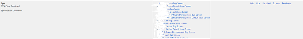

Thank you for your quick reply, here is the screenshot you asked for:
Field Configuration:

That's actually not exactly the screen I'd like to see: you're sharing a screenshot from the field configuration in the global menu instead of the field configuration from the project menu. See the difference:
  • From the global menu:
  • From the project menu:
A screenshot from the project menu would ensure you did associate the right field configuration with the right issue type in your project.

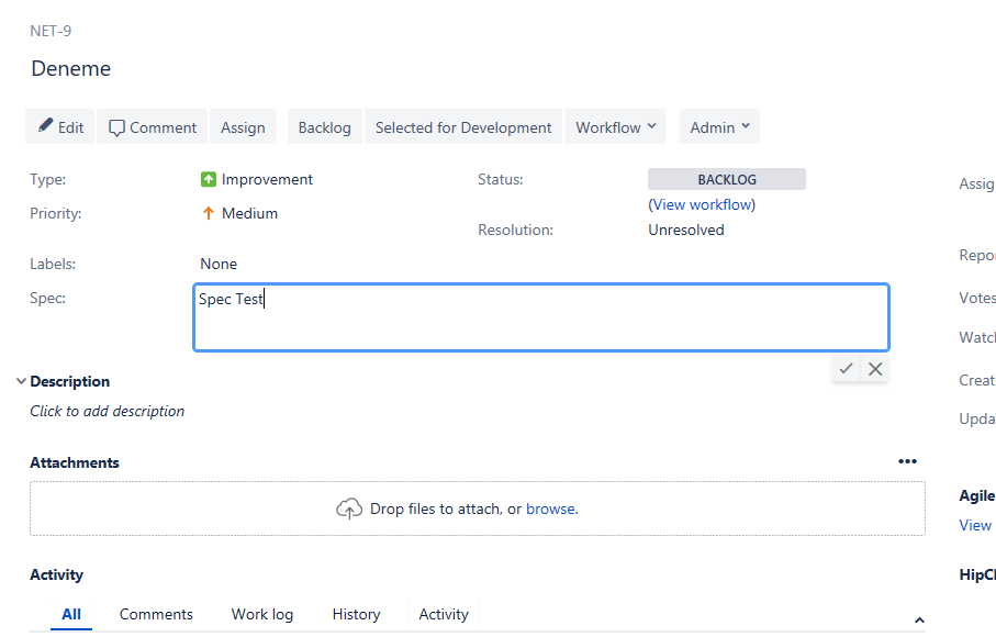

Sorry for that,  yes there is a problem with my field. It is not wiki style here. How can I change this? Field seams wiki style type in global settings, but here text. Where did i go wrong?
There is only one spec field, I'm sure of it. But first I created the field as text, and added on the screens. Then I found the solution to change it to wiki, and changed it. Maybe that's why it's still text type here? What do you think and suggest?

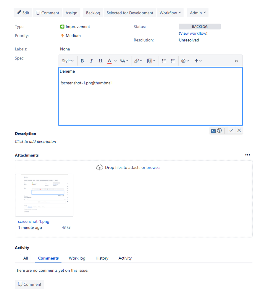

I think I did it finally, When I click field <Renderer> it opened field above all the time, I didn't notice until now. I changed the link, and then I could reach my field. So I changed it to wiki style finally. It should look like below, right?
