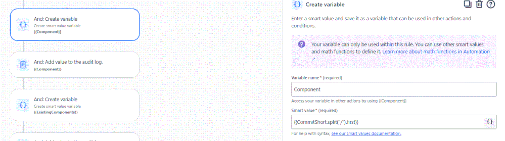

I've been able to:
  • Fetch the component name from a commit using text formatting smart values.
From {{commit.url}} I've follow documentation Automation smart values - text fields | Cloud automation Cloud | Atlassian Support
I save the component name on this variable {{Component}}, that I use later.

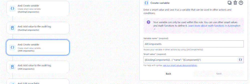

  • Update the component field

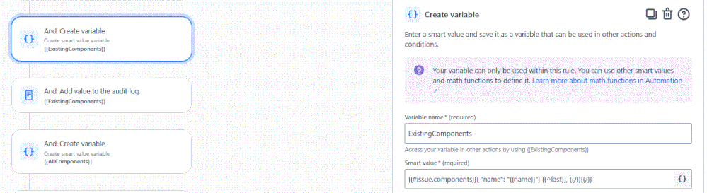

Creating two variables:
{{ExistingComponents}} = {{#issue.components}}{ "name": "{{name}}"} {{^last}}, {{/}}{{/}}
{{AllComponents}} = {{ExistingComponents}} , { "name": "{{Component}}"}

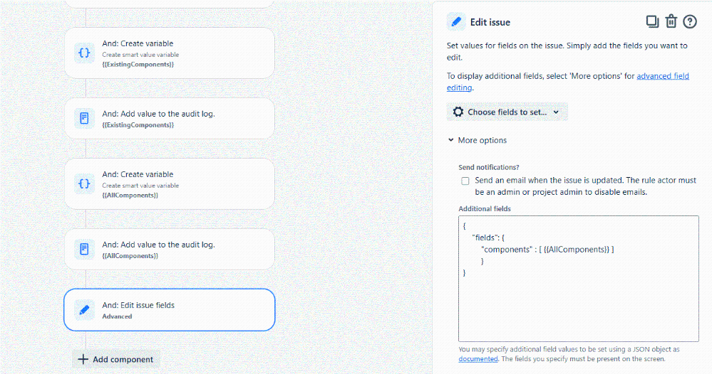

Editing issue Components field:
{ "fields": { "components" : [ {{AllComponents}} ] } }

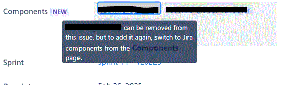

All Compass Components were overwrited and when I hover over the components I get this message:
component-name can be removed from this issue, but to add it again, switch to Jira components from the Components page.

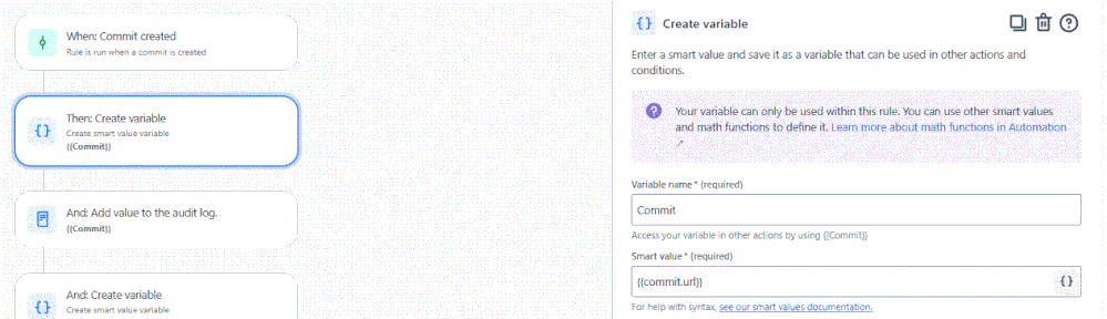

On commit creation

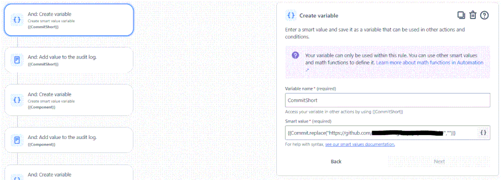

1. {{Commit}} variable is {{commit.url}}
2. {{CommitShort}} variable is {{Commit.replace("repo instance", "")}}
3. {{Component}} variable is {{CommitShort.split("/").first}}
After these steps we are able to get the component to add to the issue.

4. We identify the components that are currently in the issue by creating {{Existing.Components}} variable {{#issue.components}}{ "name": "{{name}}"} {{^last}}, {{/}}{{/}}
5. We add the new component identified in step 3. Creating a new variable {{AllComponents}} that concatenates the variables from step 3 and 4: {{ExistingComponents}} , { "name": "{{Component}}"}
6. All components, old and new, are added to the Component field.

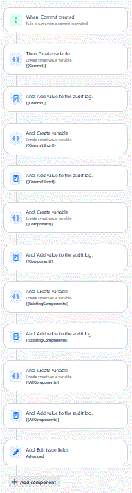

"fields": {
Components are informed, but Jira does not consider them to be Compass Components, when we hover over the component we get this information.
These components are present in our Compass Component application, with the same name, but when informed via automation, are not identified as Compass Components, instead old version components are created and informed.
Compass switch is active for those projects.
Overview of the automation:

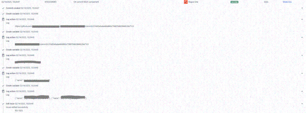

In this example, we can see how a component is identified from the commit, and shares name with a Compass component already present in the issue.
When editing the component field only one component is informed, a non Compass component, and the Compass component is not present anymore.
