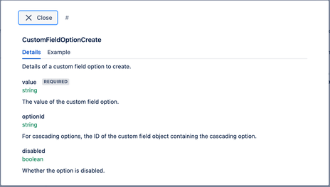

I think you need to make sure you are not including optionId because when I click on the CustomFieldOptionCreate array definition it shows that optionId is "For cascading options, the ID of the custom field object containing the cascading option."
So I think you don't need to include any kind of id at all if you are doing a Create, because it should automatically generate it. If you are doing an update, well, you'll need the id then because you're editing an existing option value.
But probably the key thing here is that you don't need optionId if your field is not a cascading select.
