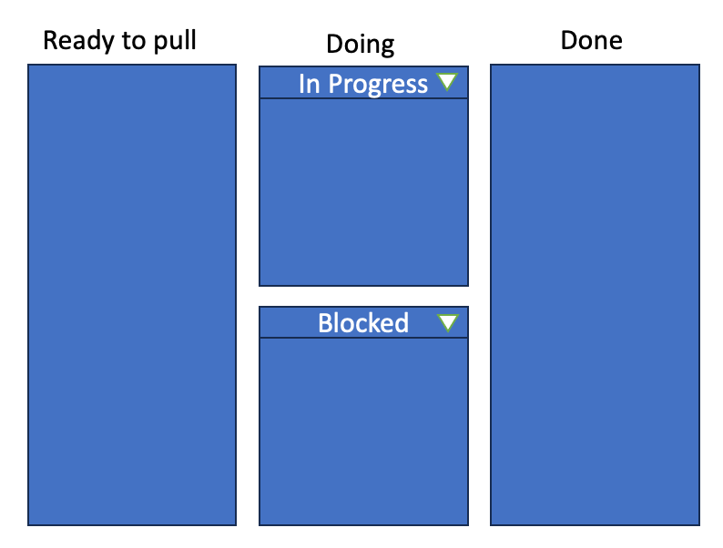

This is the mock up of our case: Bildschirmfoto 2023-07-18 um 10.36.27.png
The criteria for these issues are simple to explain: The issues "in Progress" are issues which we are currently working on, but once the issue has to be reviewed/worked on by an external stakeholder for example (e.g. design agency) the issue card should be moved to blocked.
The project is company managed and it is rather to manage our business/work.

There is no way to do this.  The point of a swimlane is to go across the board and break up your columns into similar sections.
Jira does do something like this when you are moving issues around though - if you pick up an issue to drop into another column, you'll see the column broken up into its different status, much as you show in your diagram, but the overall view will not look like that.

I concur. There is no native method to do this.
If "In Progress" and "Blocked" are statuses you could split them into separate Columns on your board, but you can't divide a single column in this manner.

Thank you all, I divided the column by adding a second status!
