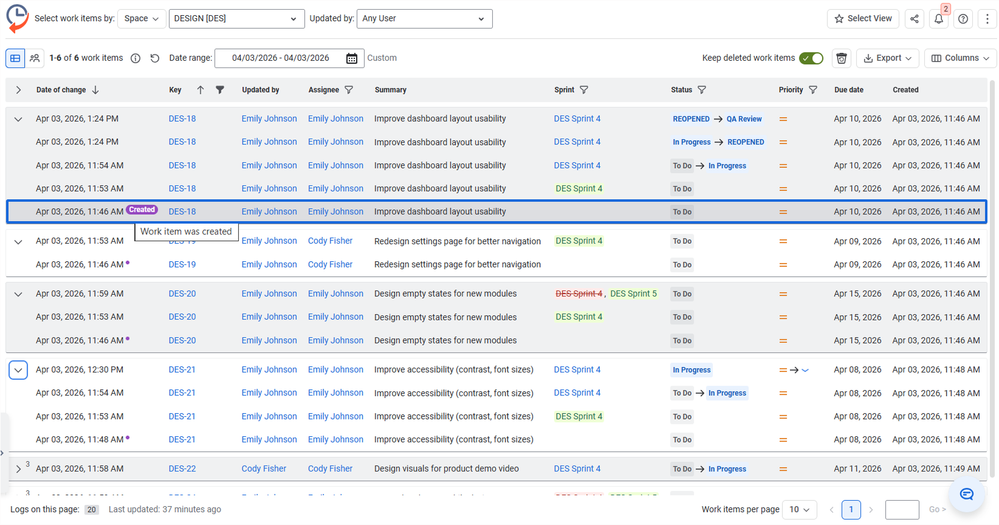

Using Issue History for Jira (Work Item History) app by SaaSJet, you can see what a work item looked like at the moment it was created and then keep track of how its field values changed afterward.
With the app, you can select the project and the date range that you want, and then locate the work item you're looking for. The Created record displays the work item's original state, enabling you to see the field values it had when it was created.
All the changes that come after that are shown in chronological order, together with both the previous and the new values.
The report can be easily customized using the Columns menu by adding the fields that you require, including any custom fields. For instance, in the screenshot shown above, I have chosen Sprint, Status, Priority, and Due date, but you are free to include your own custom field and verify its initial value in the created record.
You can likewise limit the report to a single work item or to a number of work items.
If you want to save the results or carry out further analysis, you have the option of exporting the history report to CSV or Excel.
