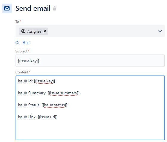

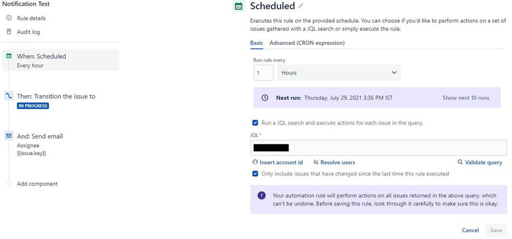

In my opinion this can be achieved using Automation. The automation can achieve the following:
  • Scheduled at a frequency, as per the requirements
  • Use the JQL to identify the required issues
  • Transition the issues to a particular status
  • Send an email to the Assignee, with appropriate details
The below screen shots showcase a similar implementation.

Thanks for your reply @Gaurav .
For the notification by email, does one email for each issue will be send, or is it possible to send 1 email with all issue which has been transition ?
Gaurav
July 29, 2021
@serge calderara, This will be sending an individual email for each issue with all the specific details.
Alternatively, if a single consolidated email is required, then a dashboard with appropriate filters can be created and users can subscribe to it.
