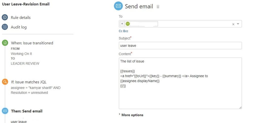

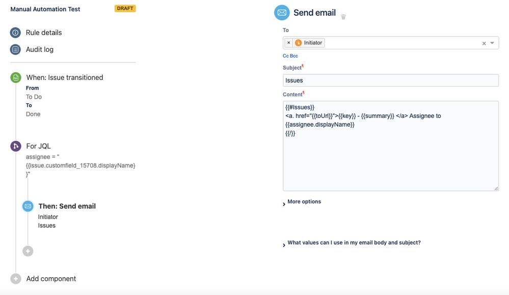

I do this but it just returns one issue while I searched it has to return 5 issues in the email.
@CRS123456 your automation seems to be ok.
Did you check just your JQL, does it return all the issues you want?
Does your issue is in the JQL step or the email step?
Can you share a screenshot of the email step too?
i think the email is fine, also, you say you get 1 issue in the email, i think if the problem was the email you would have get nothing...

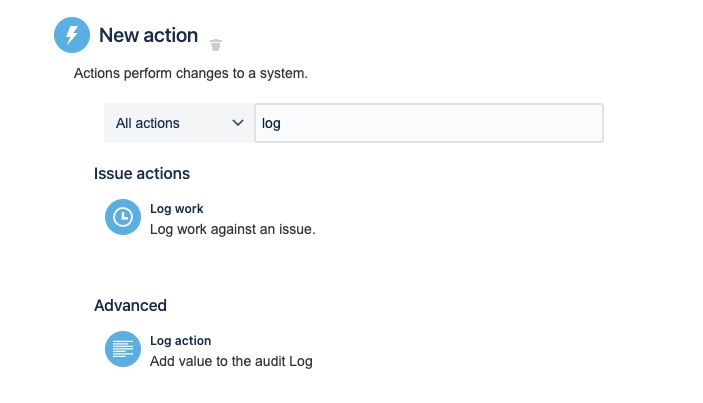

try to add "log" step and log your JQL result, than see what the logs print
Thank you @Nir Haimov
I'm new and I don't know how to use "log"? where can I add it?
Hi @CRS123456
It's ok, you can add "Log" action anywhere you want in the automation process.
Simply click to add new action and choose "Log Action" (not "Log work") :)
@Nir HaimovI found it and put it in after the IF.
It wants some value. is it right? I put {{now}}.
I saw some problems like mine!! where can I see the results?
@Nir HaimovDo you think if condition points to all projects and all issues?

This can't be exactly perform as you whish in Jira Server (in cloud they have this feature).
What you can do int Server is the following
But this will send you 1 email for each issues found in the JQL (and not 1 emails with all issues in it)
So i think that eventually it will better to do this with ScriptRunner

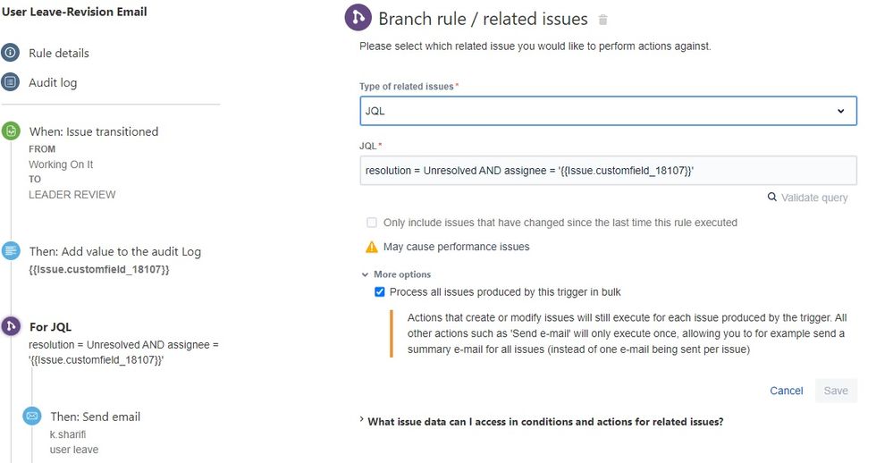

For the server/data center version of automation rules, you can use the bulk-processing option with that branch, and so send only one email: https://confluence.atlassian.com/automation/run-a-rule-against-issues-in-bulk-993924653.html

Correct; my understanding is the branches also support this bulk processing feature...not just scheduled triggers.

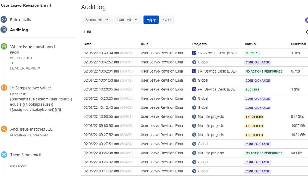

but when I put unresolved condition in the scheduled it returns 4900 issues and throttled so this is not right.
@Nir Haimovwhen I looked at the audit log I saw config change was in the global but when the rule was run, the project was ESD while I want this rule runs in all projects.
Some work is not right and I don't know where!!!

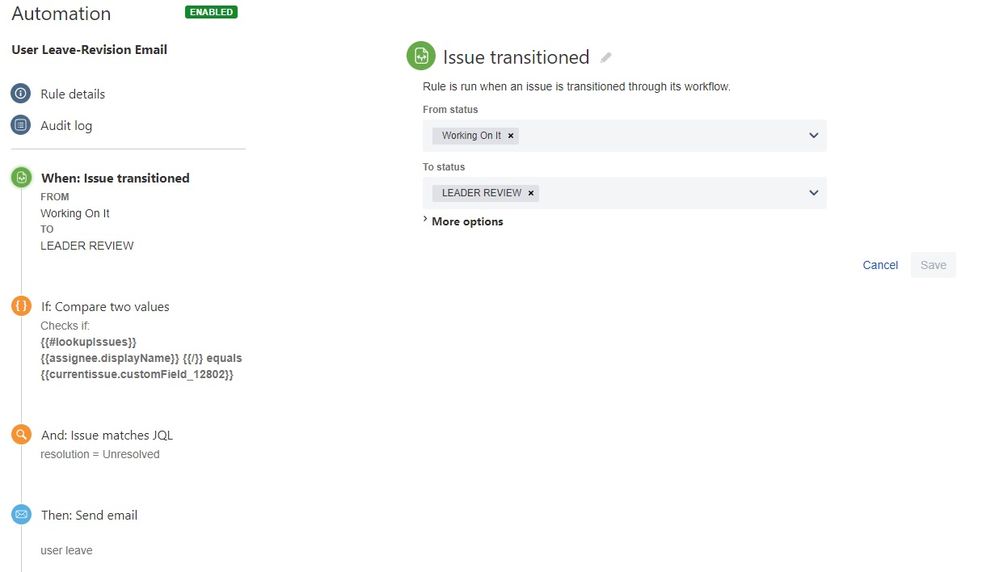

Hi @CRS123456 check in your "rule details" (top left) make sure this rule configured for all projects and not specific project
@Nir Haimov Yes It's on all projects.

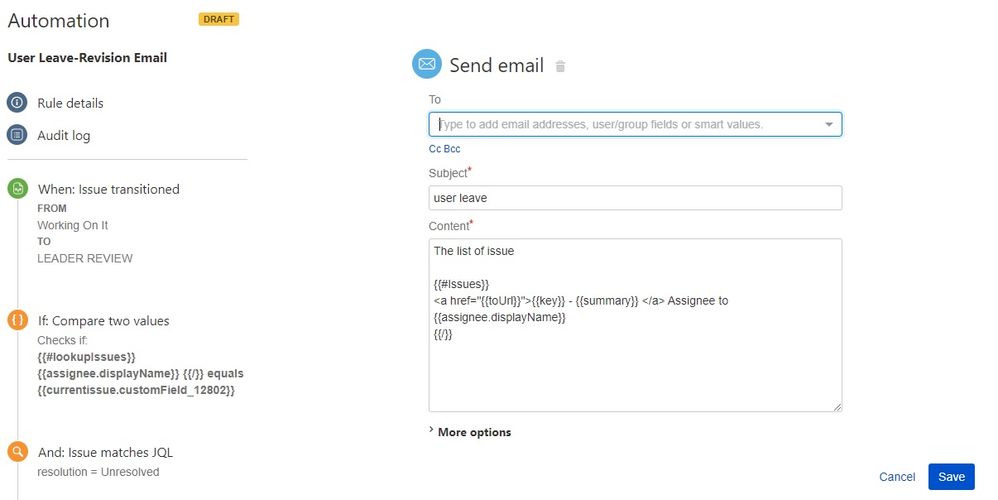

I'm trying a different way but it still shows me one issue in the email.
I can't understand!!
Hi @CRS123456
That's because your automation is wrong.
You should use it with "schedule" as @Bill Sheboy suggested.

note: I changed Full Name field to a user picker because It doesn't anybody write wrong. Also, it doesn't matter for me if had a schedule or not and when I start automation with issue transitioned all commands run in in one project whereas I want the result in all issues.
@Bill Sheboy @Nir Haimov Thank you, guys.
Finally, I found the answer. I'm a seeker finder. I want to scream.
