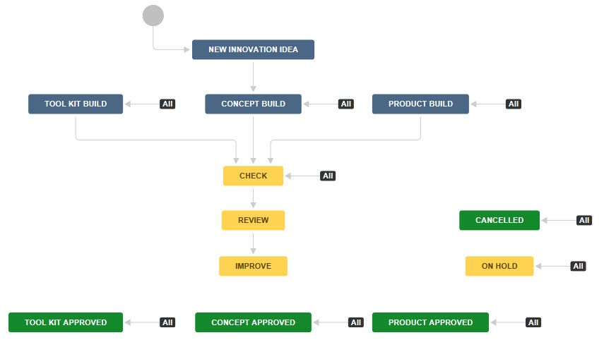

I did try this approach however I wanted everything on one board and couldn't do that as boards and workflows seem to be 1:1.
Thus I have everything in one workflow where i simplified things significantly. It is however dependant on a process controller/ facilitator to be functional (and a few conditions to ensure approval flows work as intended) (see the workflow attached) - the basic workflows are Build - check - review - improve - approved. All for tool kit, concept and product. (the concept being completed prior to the other two which are then in parrallel.)
Happy to explain more if people have further questions to our approach.

Hi Chris - I believe I understand what you need.
I have overcome my concurrent steps with having multiple issue's generated. i.e. Once my concept has run through build -> check -> review -> improve -> concept approved it automatically (through JMWE post-functions) generates two issues of the same type to run through the same worflow for Tool Kit and Product. I did it this way to have everything on one board.
Next to that I have 12 people doing the review (12 sub-tasks are automatically created with transition to Review and viewed on seperate board) which inhibit the tranistion of the original issue.
Thus you could have an overall Task based workflow for Task A of backlog -> in progress -> complete. Once you move Task A to in progress it can automatically generate 3 subtasks (B C and D) which can all be seen on a seperate Board. Task A is then blocked by B C & D until they are in status complete.

Max,  thanks also, I just ran into the same situation and was scratching my head on how to get it done and the workflow be acceptable to management.  Just to make sure that I have got your plan down.
I create an issues and MAKE sure that the concurrent tasks are assigned as subtasks and the original issue CANT transition to done until the subtasks are done.  Is this correct.
