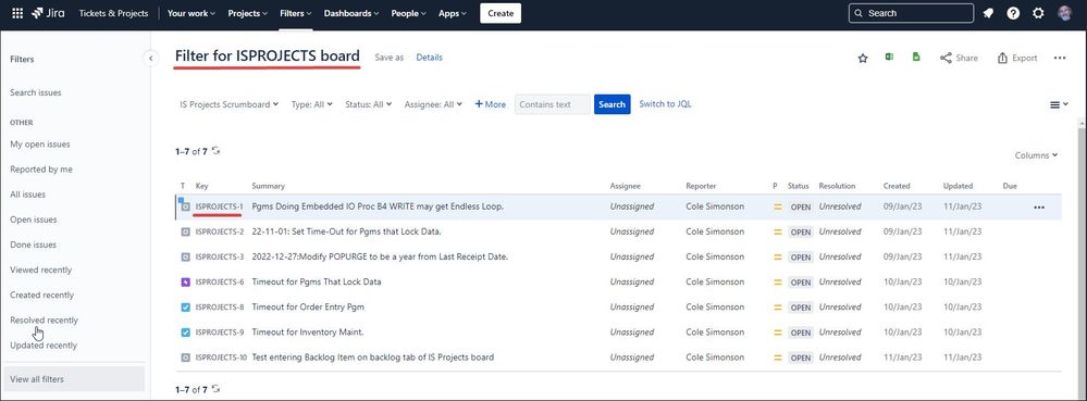

Hi @Trudy P Claspill - Thanks for your help.  I believe, at first, I had no filter set up, so earlier today, just trying stuff, I created one that only specifies the project name for the project that I want the Issues to show up in.  Here it is:

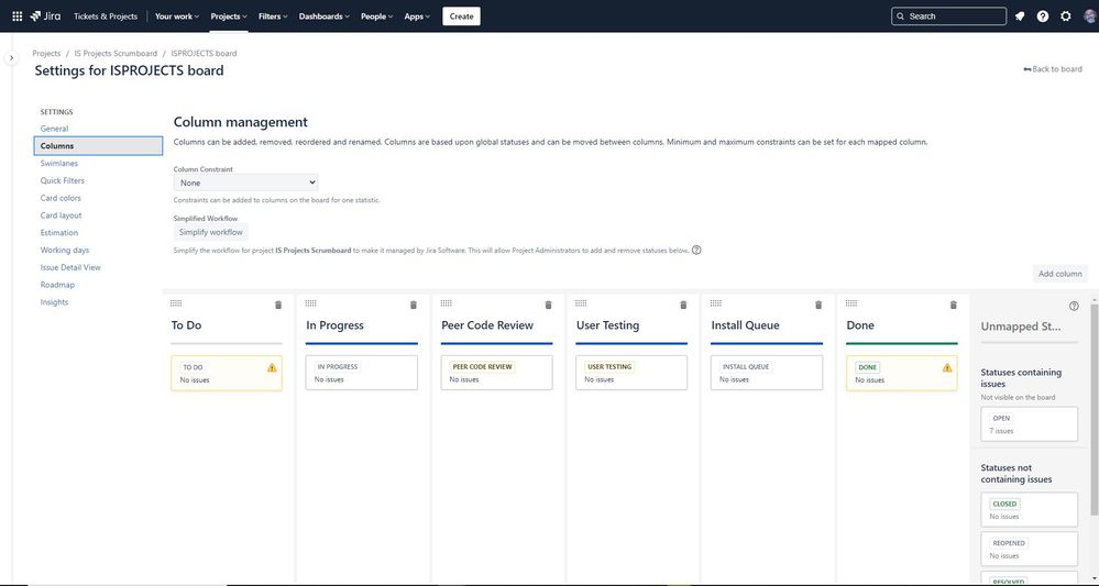

And, here are the Statuses for Columns:

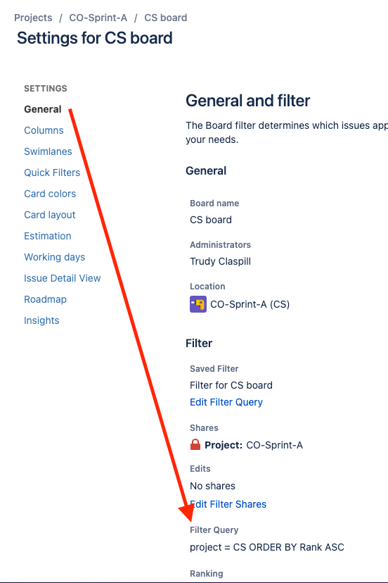

All boards have a base filter that selects which issues will be displayed in the board. In the image you pasted that shows the Columns, click on the General option above that on the left. Scroll down and you'll see the Filter Query. Example:

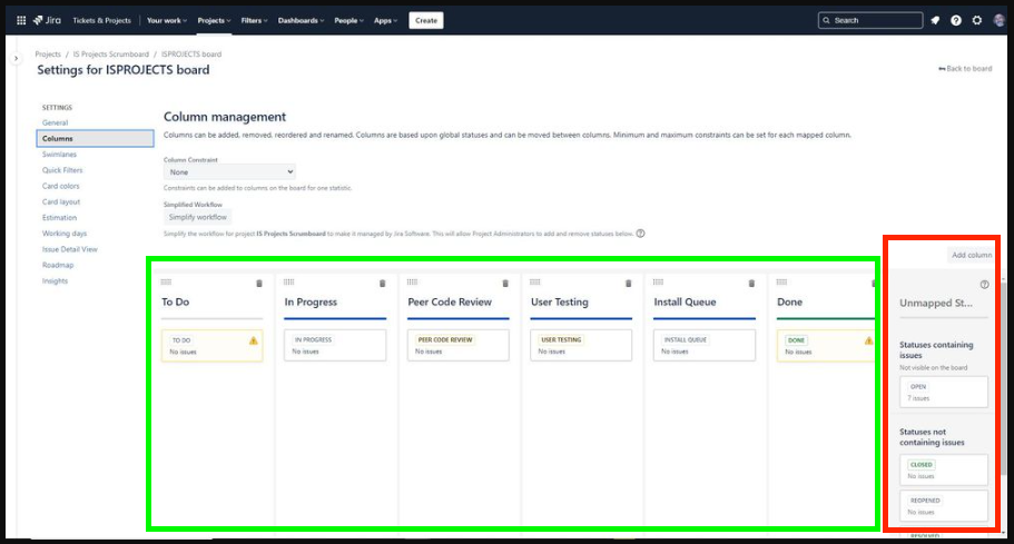

If your board filter is simple, specify just the project similar to the one in my example, then the issue likely has to do with you not having mapped all the Statuses to Columns as shown in your image here:
This page shows you all the possible Status values for issues that are pulled in by the Filter Query for the board. All the Statuses (the little boxes) have to be mapped to columns (in the area within the green box). Any issue that have Statuses that appear in the Unmapped Statuses area (the area within the red box) will not be shown in your Board nor in your Backlog.
While this page is titled "Columns", you may think that means just the columns that appear in the Board view. But this also applies to what issues will show in your Backlog view. The difference is that in the Backlog view the information is not arranged in Columns; that applies only to the Board view.

@Trudy P Claspill  - You nailed it!  Thanks so much!  The issue was that the column you highlighted in red directly above - Unmapped Statuses - had a Status of 'Open', showing '7 issues' - all of my missing issues.  When I moved it over to the To Do column, then all of my issues show up on the Backlog page for the Project and I can pull them into the first sprint that I would create.
Question - I'm not sure of the implications of having these other unused statuses in the Unmapped Statuses column; maybe issues disappear when they are Reopened, for instance.  So, I dragged Reopened to the In Progress Column, and I dragged both Closed and Resolved to my Done Column.  That should work, right?

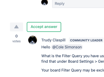

To accept an answer you have to accept the entire answer thread vs. one individual response within the thread.

Regarding the other statuses in the Unmapped column, you are exactly correct. If issues moved to those statuses, then those issues would no longer be displayed on your board nor in your Backlog screen. You do have to includes those also in the columns.
And, when working with a Scrum board, when you get to the point of running your sprints and are ready to Complete a sprint, you will get a pop up telling you how many issues are "unresolved" and asking if you want to move those back to your Backlog or to another sprint. What Jira means by "unresolved" in that case is that the issues are in a status that is not mapped to the column farthest to the right (the one you named Done). So, if you Closed, Resolved, and Done statuses all mean that the work is complete, then you do want to have those all mapped to that right-most column.
