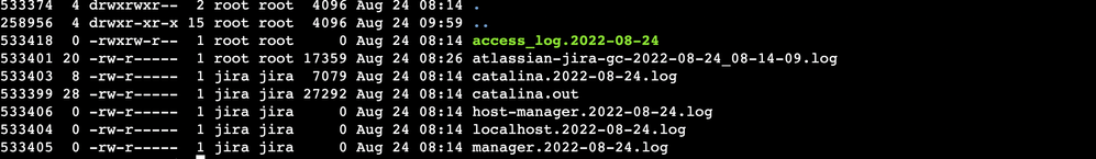

Can you share the output of
 ls -lisa on <JIRA-HOME>/log folder
as well a screenshot of your filezilla screen?
Shubham Vishwmabhar
August 24, 2022
Hey @Kurt Klinner ,Please check below Screenshoot

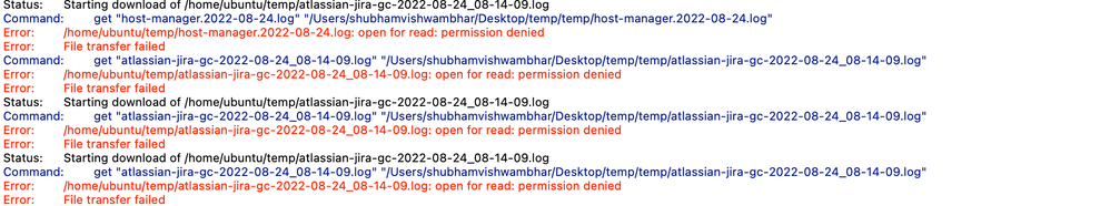

Shubham Vishwmabhar
August 24, 2022
@Kurt Klinner @Ismael Jimoh  I have copied the file to TEMP folder but , now I'm Not able to Download it in my Local System.
