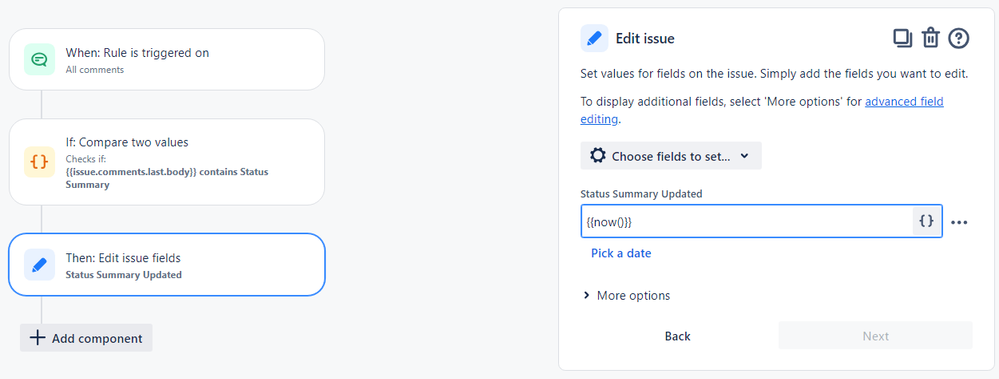

You can also do the same for adding a comment containing 'Status Summary':

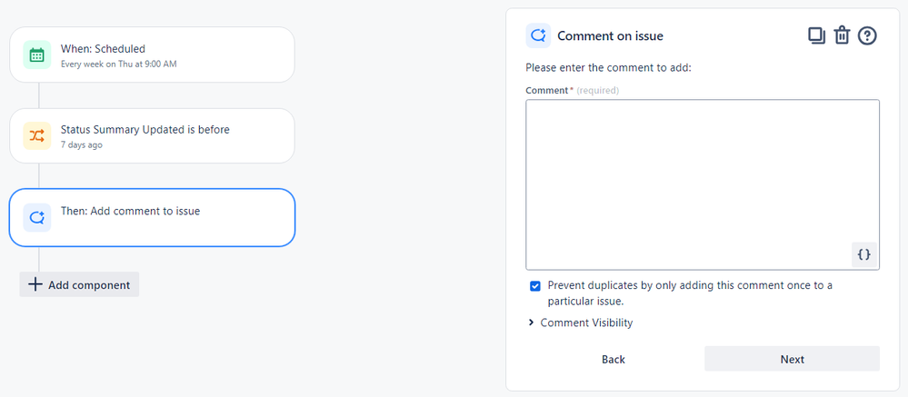

You can then create a scheduled automation rule that runs once a week and compares 'Status Summary Updated' to 7 days ago which then creates your comment on the issue.
