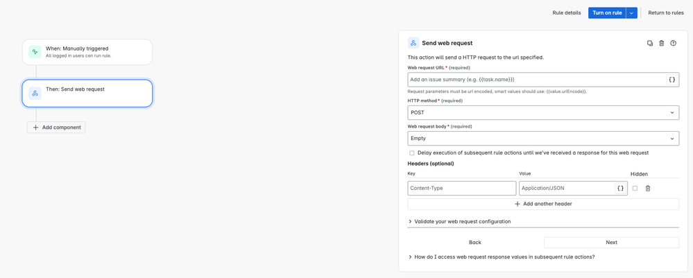

The simplest way to implement this logic is by using Jira automation rules.
In your case, I recommend using a "manual trigger" to initiate the rule. You can read more about it here: https://support.atlassian.com/cloud-automation/docs/jira-automation-triggers/.
For the action, configure a “Send web request” step to perform the necessary API call.

On JIRA Cloud you could  create a transition that trigger a webhook or create an automation (manual trigger) and use Send Web request as action. You could also create a custom app.
