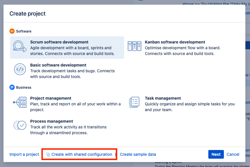

If you want to only migrate one project with 0 issue data, what you can do is create a new project on your source site, and use the existing project as a "source". You can do this using the "Create Project" dialogue, and selecting "Create with shared configuration". Here, you will choose the project you want to use the configuration from, and you are set.

If you want to only migrate one project with 0 issue data, what you can do is create a new project on your source site, and use the existing project as a "source". You can do this using the "Create Project" dialogue, and selecting "Create with shared configuration". Here, you will choose the project you want to use the configuration from, and you are set. :
is this also valid if my data center environment (source) is hosted on different server and cloud environment (destination) is hosted on other server??

Hi @Rajat Krishnan ,
Yes, this should function regardless of where your Data Centre infrastructure is hosted. You will need to open certain firewall ports as defined here: https://support.atlassian.com/organization-administration/docs/ip-addresses-and-domains-for-atlassian-cloud-products/
I would recommend creating at least 1 issue that uses all of the custom fields you need, however, to ensure everything gets brought to Cloud.
