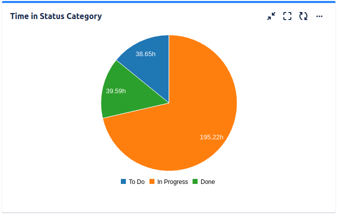

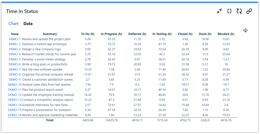

If you consider the idea of using an app, our Great Gadgets app might be the perfect solution. It offers Control Chart gadget that is similar to the Jira's report but much more advanced and configurable.
In addition, the same app offers a Time in Status gadget that lets you calculate the "time in status category" directly - so you will get the total or average time in "In progress" category with just a few clicks!
And both gadget display a Data tab with details at the issue level, so you can identify where the delays come from.
