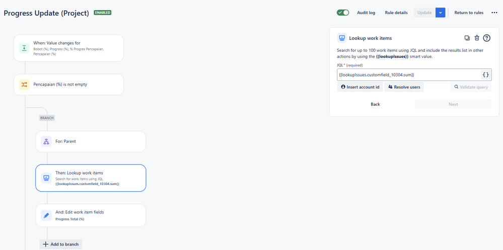

The Lookup Work Items action requires a valid JQL expression, and the one shown for your rule is incorrect.
For the rule you show, please change the JQL to this:
parent = {{issue.key}}
That will find the child issues of the branched-to parent issue, and then the lookup result sum will work.

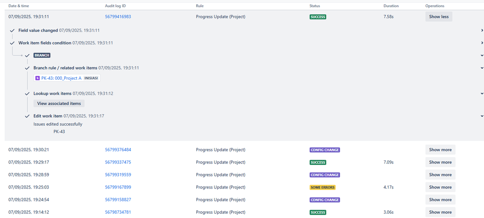

Yes, I’m using Jira Cloud and I’ve already tried the approach you suggested. However, the result in the audit log shows an some errors with the following message:
Unable to run the search while custom values were being defined: .
Custom Smart Value JQL Search: "(parent =) AND (project in (10057))" - Error in JQL Query: Expecting either a value, list or function but got ')'. You must surround ')' in quotation marks to use it as a value. (line 1, character 10)
Where did you use that JQL in the rule? The error indicates there is no value for {{issue.key}} at that point in the rule.
For the rule you currently show (as the time of this post on 10 July), the JQL would be with the Lookup Work Items action inside of the branch to parent. And so that error is not possible when there is a parent.
Please post an image of your current, updated rule.

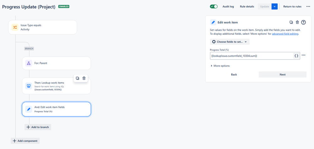

The JQL in the Lookup Work Items action is still incorrect.
It should be this:

1. Lookup Work-Item and select the parent.
2. Create a var and set its value to {{lookupIssues.Story Points.sum}}
This will set your var with the sum of all story points in the parent childs.
from there, you can add it to your parent.

simply run a lookup work-item and then fetch the data like: {{lookupIssues.YourCustomField.sum}}
yes, it still doesn't work on me. Just to add a bit more context, the data I'm trying to get and sum is dynamic and not manually entered. The field value itself is the result of a calculation using a Smart Value from a separate automation rule.
Could that possibly have an impact on why the current rule is not working as expected?

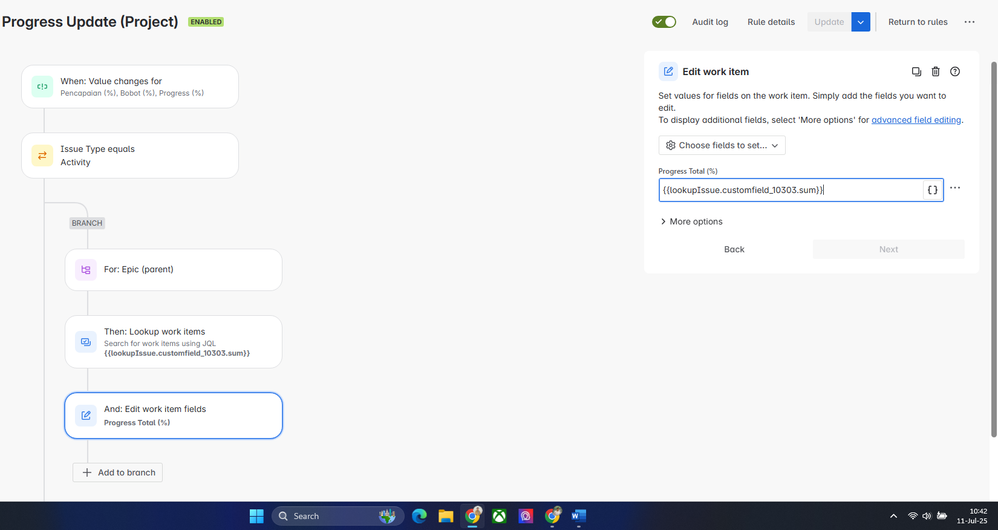

Perhaps I should explain it again more clearly and simply from the beginning, and I would really appreciate if someone could help identify whether the issue is coming from the hierarchy configuration or the smart value I’ve used.
I created several child issues under one parent, where each child has a custom field called "Achievement (%)", and the goal is to sum all of these into the parent’s custom field called "Progress Total (%)" (similar to rolling up story points).
However, the value shown in the parent’s "Progress Total (%)" field is often incorrect — sometimes showing null "add a number", 10, or 20 — even though each child clearly has 20%. For example, with two child issues at 20%, the expected total should be 40%, but that’s not what is reflected.
If anyone has experienced a similar issue, I would truly appreciate it if you could kindly share the step-by-step instructions you followed to resolve it
