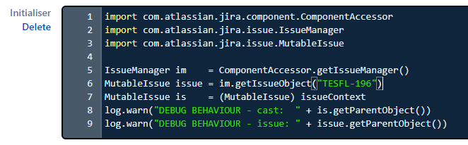

Fabian
August 12, 2021
@jack ma
i tried this in a test behaviour and both is working. I hope this is it what you are searching for:
Kind regards.

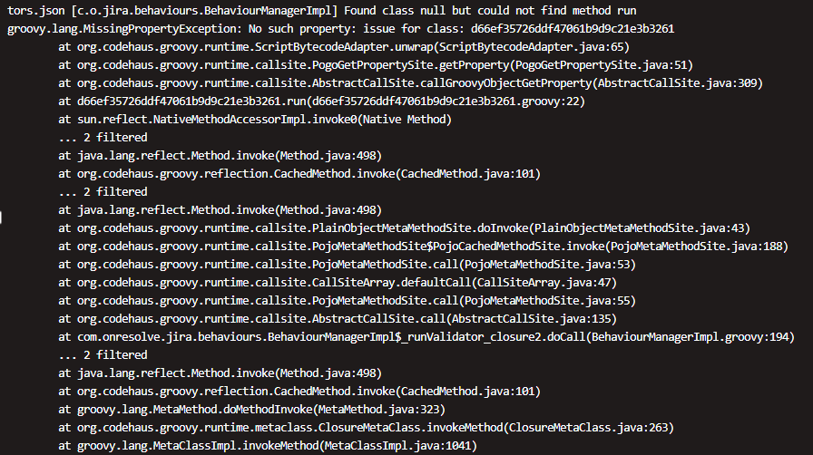

jack ma
August 12, 2021
Hi@Fabian Laqua
I really appreciate your help.
After I used your code to execute it, an error was reported. The error message is as follows:
Best regards.

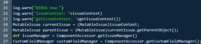

Fabian
August 13, 2021
Dear @jack ma ,
what scriptrunner version do you use?
In an behaviour, you get the current issue with the issueContext
Plz try, if it is empty or not?

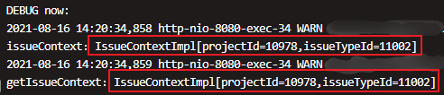

This works too (Full code, no import needed in a behaviour, initialiser!):
log.warn("DEBUG now:")
log.warn(issueContext)
log.warn(getIssueContext())
Source: How to get current issue object in Behaviour ? (atlassian.com)

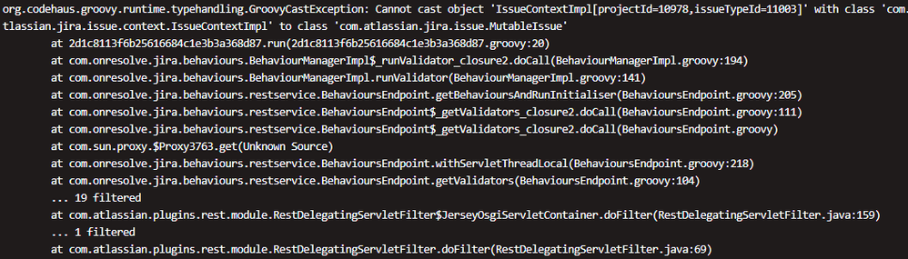

Fabian
August 16, 2021
Dear @jack ma
now i understand your problem. There isnt a sub-issue yet. So you cannot cast to mutableIssue.
Why do you need the parent issue in the create mask?
Is there a special field you need to display or process?
If you need to display that data, then you can use a post function in the sub-taks-create transition to get that field.
Or do you need to recalculate something with this field in the create mask?
And that underlying wont work either in the create transition. I tried it out. But if you that sub-issue in edit the "underlying" works.

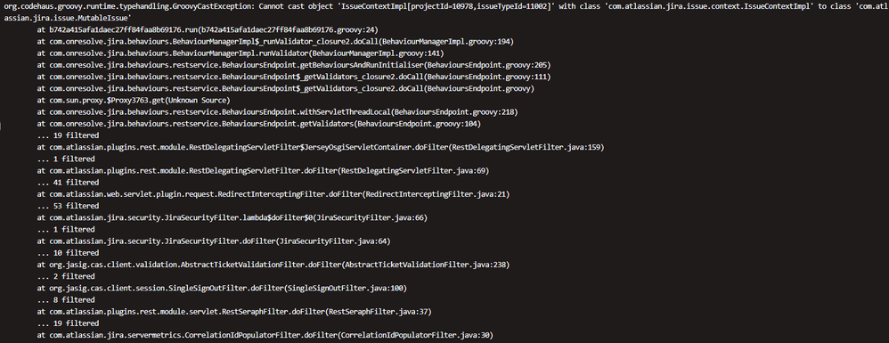

Fabian
August 16, 2021
@jack ma
This works only in the create transition:
import com.atlassian.jira.component.ComponentAccessor
import com.atlassian.jira.issue.IssueManager
import com.atlassian.jira.issue.MutableIssue
import com.onresolve.jira.groovy.user.FormField
IssueManager im = ComponentAccessor.getIssueManager();
FormField formfieldparent = getFieldById("parentIssueId")
Long parentIssueId = formfieldparent.getFormValue() as Long
log.warn("TEST formfieldparent: " + formfieldparent)
log.warn("TEST parentIssueId: " + parentIssueId)
MutableIssue issue = im.getIssueObject(parentIssueId);
log.warn("FINISHED: " + issue)
With that parentIssueId, you can get the parent issue with the issueManager i posted at first.
