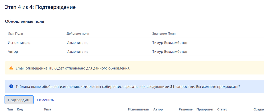

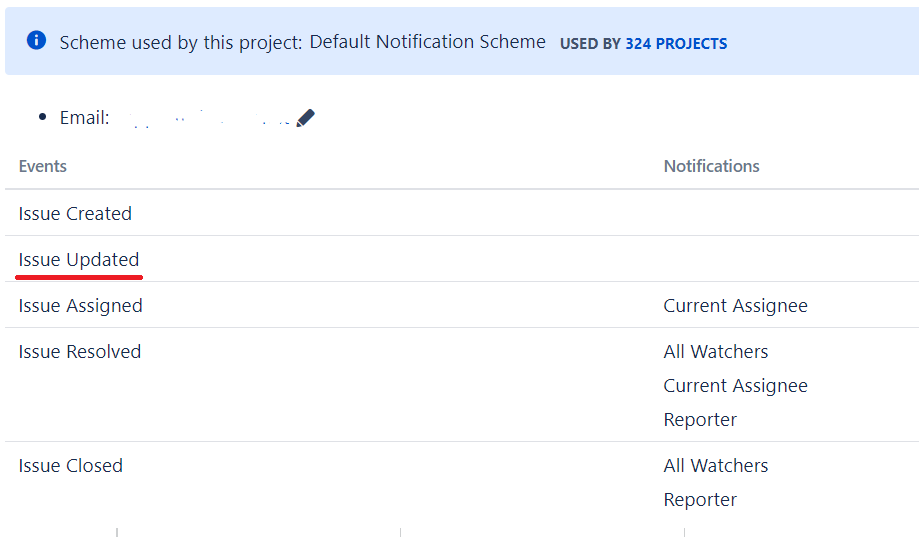

I changed the assignee in the issues, but an issues update notification was send. The event Issue Update in Scheme Notification is empty.

When you change the assignee field, I think what you are firing is actually an issue assigned event (rather than an issue updated). OK, you are effectively updating an issue, but in this is case is a more specific event. And your notification scheme have recipients set to issue assigned events.

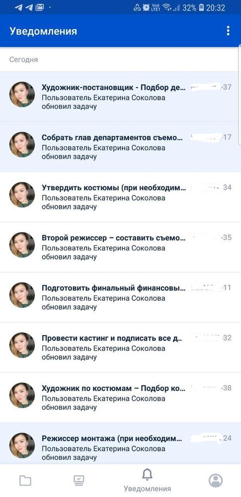

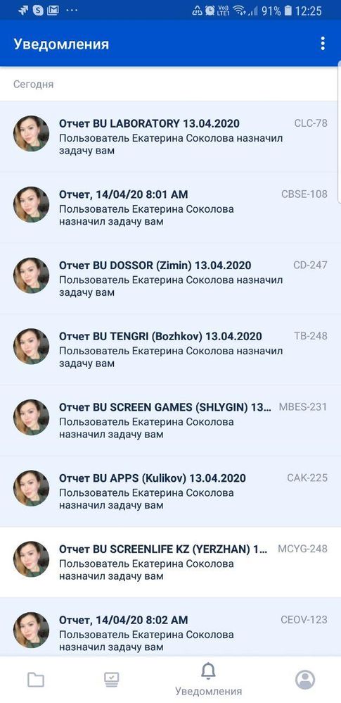

Notifications in application were about updates issues, but not about changes of assignee.
