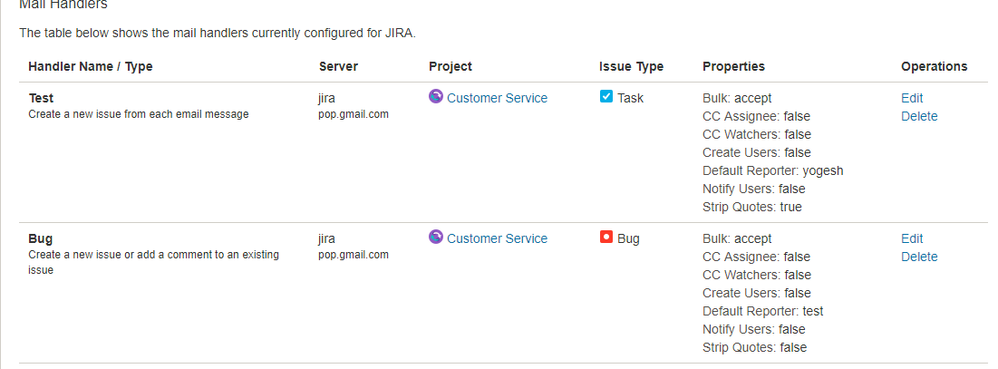

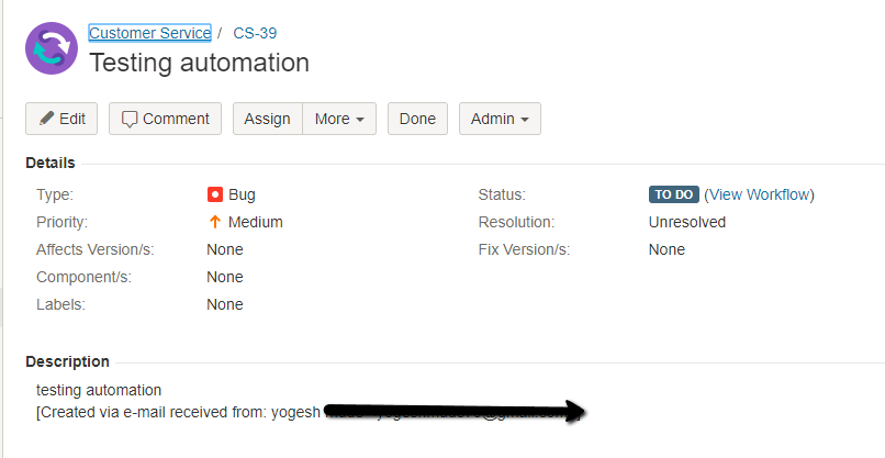

I have configured for a single and tested as well, please refer below screenshot for the same.
Hi Yogesh,
Your print screen is very helpful. My setup of the mail handlers is almost equal to yours. Instead of pop I am using IMAP.
Could it be that the account JIRA uses for authentication on IMAP should have access to all mailboxes that are used for the mail handlers?

HI @Helpdesk,
Yes, as i have been used the Gmail account for my personal setup on local instance hence I have been used pop and mail handler should have access to that particular mailbox for processing and once the ticket will create into jira then the mail will be deleted from your mailbox.
