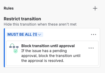

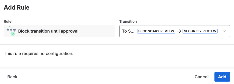

I see there is a rule in workflow creation to 'Block Transition Until Approval" and it probably is exactly what I need, but I see no documentation about how it works, and how one approves it, and how they get notified, etc.
I am not using service desk, and the configuration screens relevant to the Service Desk approval process did not appear. I just added the rule and that's it. Now what?
Any help is greatly appreciated. Thanks.

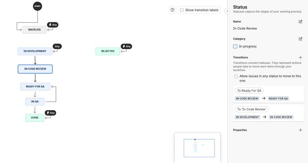

When you select a workflow and edit it, do you see 'Approvals'?

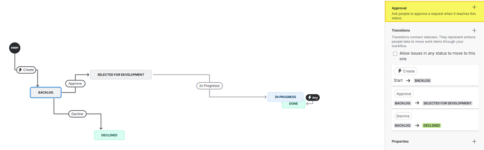

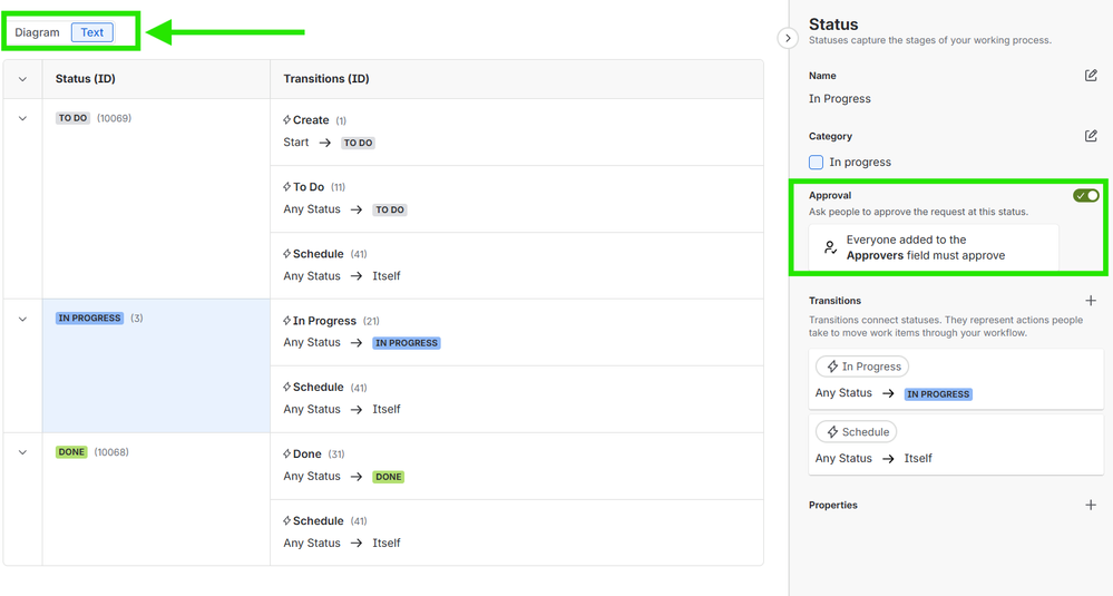

Hi @Neil Poska ,
I tried this followint steps:

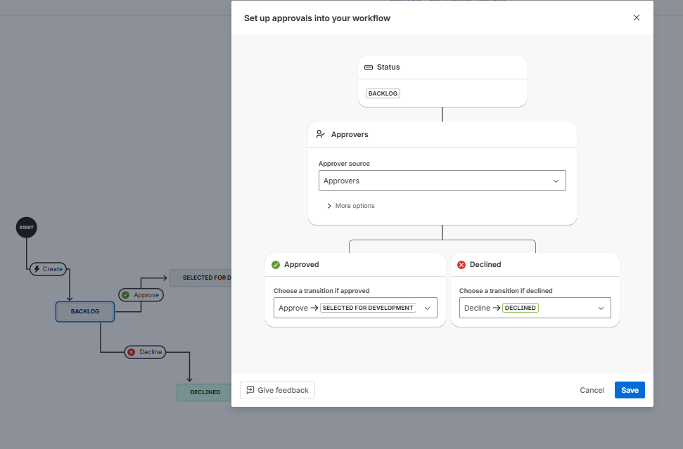

Select the status "backlog", in the right panel appears the "approval section":
Click on "+" and configured as:

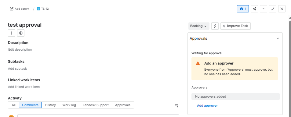

Then added the field approvers in the edit/view screen of related work type and then, in the work item view appears the required approval:
Important, the approval system apply on work items created after the change.

I am stuck because there is no Approvals section on my workflow editing page. I see yours and that would be great, but I do not have that option.
Are you sure you are not using Jira Service Management? I have that option on our JSM project, but not regular Jira projects.
