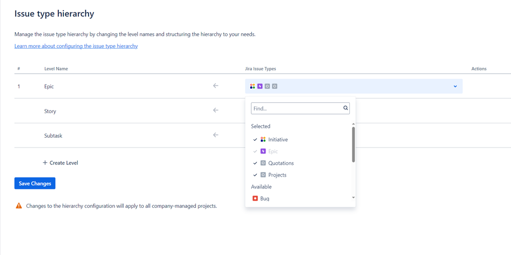

I have members of XYZ project that would like an extra level on their issue type hierarchy.  When I go to the screen to perform this action for them, there is a warning that says "Changes to the hierarchy configuration will apply to all company-managed projects."
If I make an issue type called "Program" and XYZ project is the only one that has the "Program" issue type in their XYZ issue type scheme...what will the effect me on other company managed projects?
In the instructions, it also says "Changing your issue type hierarchy will break existing parent and child relationships between your issues.  When you attempt to modify the existing structure of your issue type hierarchy, Jira will calculate the impact of these changes and require confirmation to proceed."
Will this happen even to those projects that are not using the "Program" issue type?
I had the idea to try this in our sandbox, but someone already created a level above epic so I can not tell what will happen.  Thanks for any input

Basically, there is only one hierarchy. So creating a new issue type called program will not affect any other projects. However, if there is already a hierarchy in place like you describe in your sandbox, if you replace the issue type above Epic with Program, that will affect all projects using that hierarchy.
You would need to first coordinate with anyone using that hierarchy. If there is no hierarchy already set up in Production, you should be good to go. But others that come after you will have to conform to that structure if they want to use the hierarchy above Epic.

@John Funk There is a hierarchy in place in our production, but it is the basic Epic > Story > Subtask.
So if I add a level above Epic like Program.  Will it mess up other company managed projects even if they don't utilize the Program issue type?

No, it will have no effect on the others

I have a similar situation. I would like to add an Issue Type that is only used on my project at the Epic level. I am not changing or breaking the Hierarchy. All issue types I am using are only on my projects.
Our company administrator mentioned that adding an Issue Type at the Epic level will affect all Company Managed projects and will not be allowed.
Is adding a new issue type that is only used on my Projects to the Epic level affect other Company Managed Projects.

If you add the issue type only on the one project's issue type scheme, it should not affect the other projects.

Similar question.. I'm adding an issue type to my hierarchy to be above the epic issue type. Will this break all parent links from epic down to task/subtask? Or will it just break the parent linkage between epics and initiatives?
Issuetype hierarchy:
Initiative
Milestone (new)
Epic
Story
Task/subtask

No, it will not break the parent links at the Epic and below. It would just be the ones above Epic that are affected.

I can confirm that creating new Issue Types and adding them to the existing Issue Type Hierarchy will not cause any changes to existing projects, as long as the project is the only project using that new Issue Type via its' Issue Type Scheme.
My observation is that all new company-managed projects get their own Issue Type Scheme created when the project is first created, which means any new Issue Type will not by default be added to any existing issue type schemes (except the global default issue type scheme which should never be used for any projects).
Tldr; As long as there are no other projects using the Issue Type or Issue Type Scheme, then adding new Issue Types to the existing Epic hierarchy should not be cause for concern.
