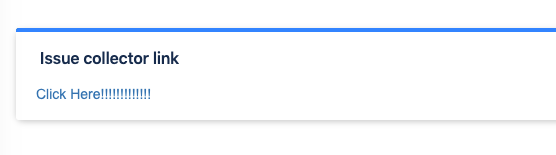

  5. Save and you will have a link on the dashboard to trigger the issue collector like this:
Let me know if this line up with what you are looking for?
