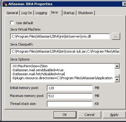

You can set your -Dplugin.resource.directories via atlassian jira properties file.
To run that exe file you need to use cmd with command like below:

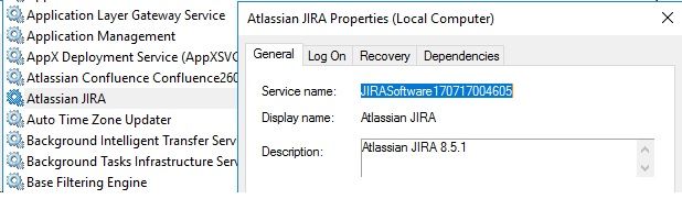

C:\Program Files\Atlassian\JIRA\bin>tomcat8w //ES//JIRASoftware170717004605
bold part is your jira service name, you can have it from services.
Then insert the line with your own custom path
-Dplugin.resource.directories=C:\Program Files\Atlassian\Application Data\JIRA\scripts
