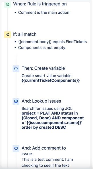

Hey @Trudy P Claspill
I've attached my automation below.
The Create Variable part was just me testing something out - I can remove it.
In the JQL of the lookup, I tried the lookup with the following:
  • {{issue.components.name}}
  • ({{issue.components.name}})
  • '{{issue.components.name}}'

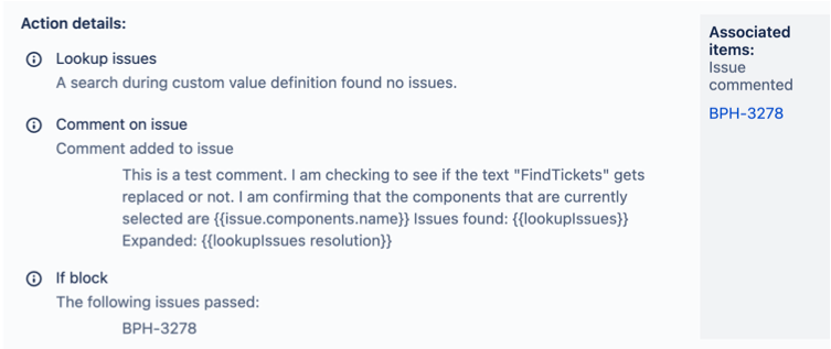

This is how I'm displaying the values from the Lookup:
Here's what the logs displayed:
Thank you for your suggestions for multiple components. I will change the JQL as such: component in ({{issue.components.name}}).
Any idea why the lookup is always displaying no issues?

Are you saying that you are trying to display the issues found by the Lookup Issues action within the comment you are adding, and it is there that nothing is displayed?
If so, then what you have added to the comment is not correct for displaying all the issues that were found in the action.
If you look at the documentation for the Lookup Issues action it provides you with the correct syntax for display information (in the example it displays the issue key) for each issue in the results set.
{{#lookupIssues}}
* {{key}}
