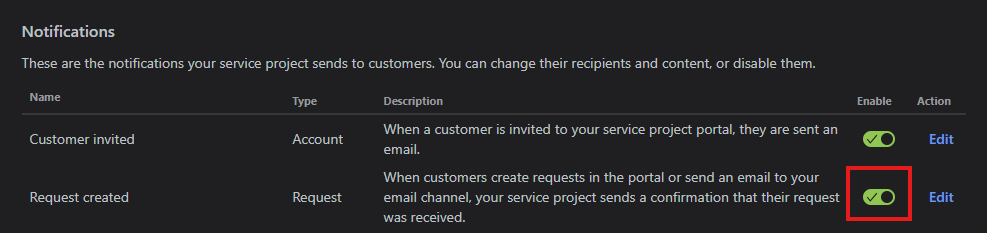

Hi @Joe Biland , everyone in your group should get an email if they have access to the project that's sending that email. And glad you brought up distribution emails -- Jira/JSM doesn't accommodate distribution emails, that's what Project Roles and Groups are for, so it seems what you're trying to do is correct. Besides ensuring everyone in the group has access to the project, have you enabled Customer notifications for "Request Created" for the project?

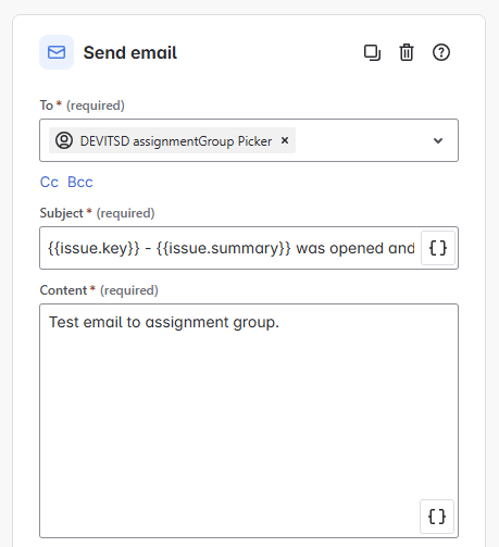

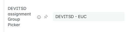

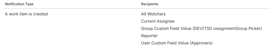

We set up a custom group picker called "DEVITSD assignmentGroup Picker".  Then we added it to our internal notification scheme to get notified when a work item is created.  The intent was to auto-assign certain tickets to a specific team, notify them, then have them do the work of assigning it to the correct person on their team.
We have an automation that assigns the group to the ticket based on criteria in our Asset schema.  In this case, the group "DEVITSD - EUC" has only me as a member and I have access to the project we're working within.

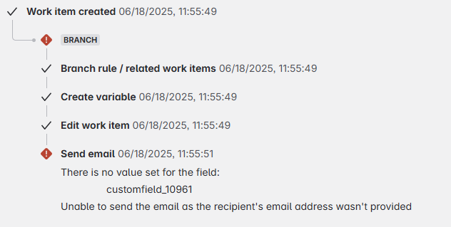

The automation works correctly to assign the group.  After a couple attempts at testing the notification configured above without received any emails, we added an "And: Send Email" to the automation.
but it fails to send the email because it seems to be looking for an address.
Not sure this alternative approach would have ever worked -- and given the timing of the automation, maybe the system notification would work if the group was assigned on creation rather than after.

Joe Biland
June 18, 2025
I opened a ticket within the JSM itself and assigned the group prior to submission and the automation email worked just fine.  I added a "refetch work-item data" step in the automation and it worked as expected.

Susan Waldrip
June 19, 2025
Ah, great! That probably explains the "no value set" error, not enough time to process the step(s) needed to populate that field. Nice!
