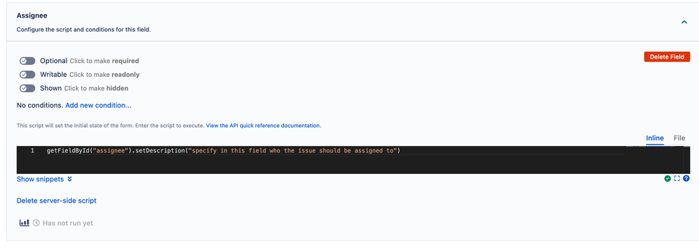

I have just done a test adding a description to the assignee field to confirm this works on a transiton screen and can confirm it works as shown in the screenshots below.
