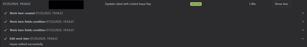

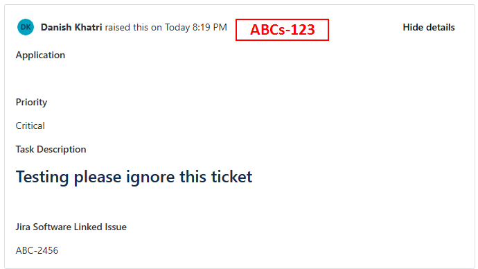

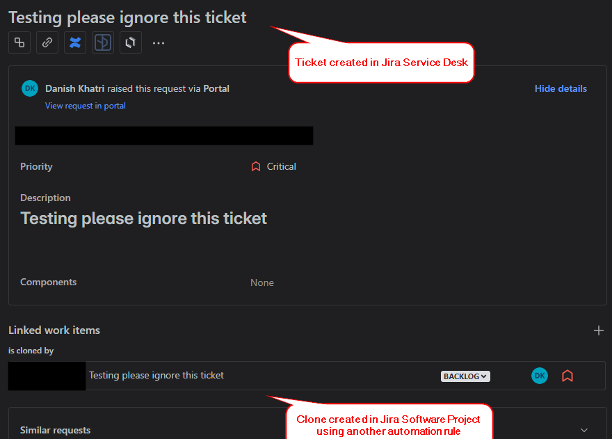

When a customer creates a ticket in Jira Service Desk, a clone gets created in the Jira software project which basically help us to communicate and provide updates to customer, now what i am trying to achieve is to show my Jira software project key in the customer service desk view using label.
For e.g.
ABCs-123 (test ticket) --> created by customer using Jira service desk
ABC-2456 (test ticket) --> clone created in my Jira software project
Now in the customer service desk view they should be able to see the clone ticket no i.e., ABC-2456 using label field.
Issue - When the rule is run it shows successfully run but label field is somehow not getting updated, How can i achieve this?
Note: the value you see below is manually updated and not using automation

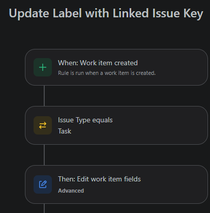

The rule is created to run in Jira service desk project.

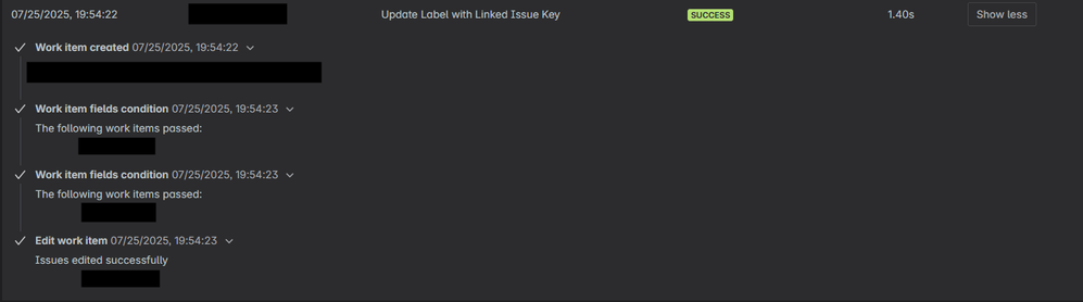

Sure but there is nothing much in the audit log other than it says "executed successfully".
So when ABCs are created in Jira Service Desk project and clone (ABC) is created in Jira Software Project then it should update the ticket no of the Jira software project item in labels of Jira service desk ticket as you can see from my screenshot.
They are both are automatically linked via "Clones" & "Is Cloned By".
Yeah i thought as well but since i am just updating the ticket no of Jira software project(ABC) in labels of Jira Service Desk(ABCs) it should use the linked issue feature and fetch ticket no from there.

Yes, ABC (clone) is created when the user the submits the request in Service Desk which creates ABCs (original ticket) and it automatically creates a link between them both (clones & is cloned by).
Then what action would be recommended to use and update the label? transition or something else?

Trudy P Claspill
July 28, 2025
Hello @danish.khatri
I reviewed your last reply (where you included images) again and I see that in the image you added the note "Clone created in Jira Software Project using another automation rule".
That would be part of your problem then.
Your rule to set the label to the linked issue key is triggered by creation of the JSM issue. It is highly probably that the rule that creates the Clone issue has not completed before this rule to set the label has been triggered. So there is no linked issue to retrieve yet.

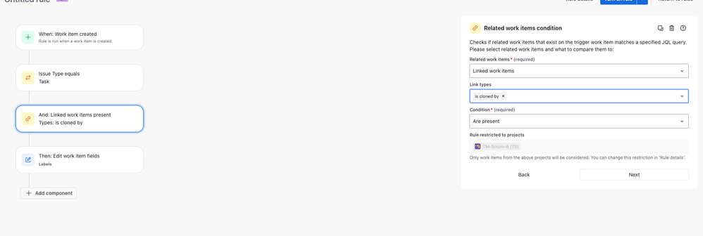

You could check that by adding a condition to this rule prior to trying to set the label
But that will only edit the label if, by chance, the automation rule that creates the clone issue has completed.
In the scenarios where the clone process has not completed you would need a separate rule to get the label updated.
I recommend instead that you amend the automation rule that is creating the clone issue so that it will also update the labels of the JSM issue. This separate rule to update the JSM issue labels would then be unnecessary.
If you show us that other rule we can advise you on how to amend it.

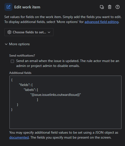

For the JSON expression you show, there are a couple of things preventing the update...
  • That link smart value is to the outwardIssue object, not just the key
  • That smart value is also a list of values, and thus even when there is only one linked issue, a list is provided...which likely will fail to create the lable
Assuming the created work item has one-and-only-one outward link, please try this expression in the JSON:
{{issue.issuelinks.outwardIssue.key.first}}
And as a safety check to prevent problems with other work item creations triggering this rule, you may want to add a smart value condition to confirm that key is in your software project.  This could be done with a text comparison, or if you increase the rule scope, with a JQL or other condition on the actual work item.

I even tried implementing the following but still it didn't update anything.
{{issue.issuelinks.outwardIssue.key}}

Please post an image of your current, complete rule in a single image, an image of the edit work item action, and of the audit log details.  Those may help explain what you are seeing.
And...if your rule is using the Work Item Created trigger, this could be a timing issue: that trigger has a problem where the rule can start before all data is available.  Seeing your rule image will confirm if this is the case.
If so, the next step would be to add the Re-fetch Work Item Data action immediately after the trigger (before other steps) and then re-test.
