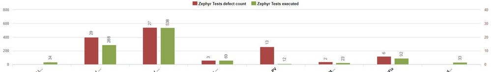

I have created an eazyBI chart with JIRA data that will list all the test executions and defects for each cycle. However, these cycles are sorted in the alphabetical order. Is there a way to sort them based on when the cycle was created?
I would like to see the data of the most recently executed cycle to the right all the time.

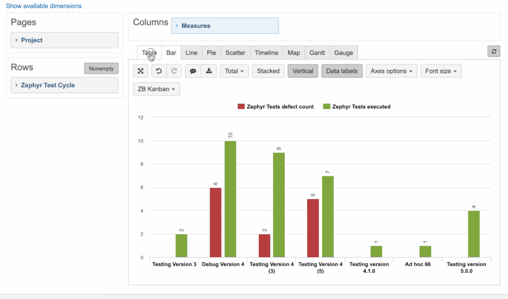

Test cycle start and end dates are imported into eazyBI as well, and you may use them to orders records.
Switch to Table view (while adding or removing measures or dimensions, we recommend switching to the Table view to follow the changes) and add Zephyr Test Cycle start date as a column. Then order data by Zephyr Test Cycle start and Remove the column, the ordering will remain. Switch back to Bar chart.

@Zane eazyBI Support Thank you so much for the demo and that helped.
