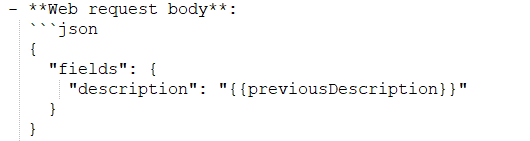

- **Web request body**:

Finally, if your Description field contains markup / formatting, the endpoint will likely return the value in Atlassian Document Format (ADF), and so the way you are trying to update the field as simple text will not work.

If you need to return the value with an ADF format, please read the documentation on using the REST API with that format.  It is likely additional JSON encoding functions will needed to prevent errors when making the request.
