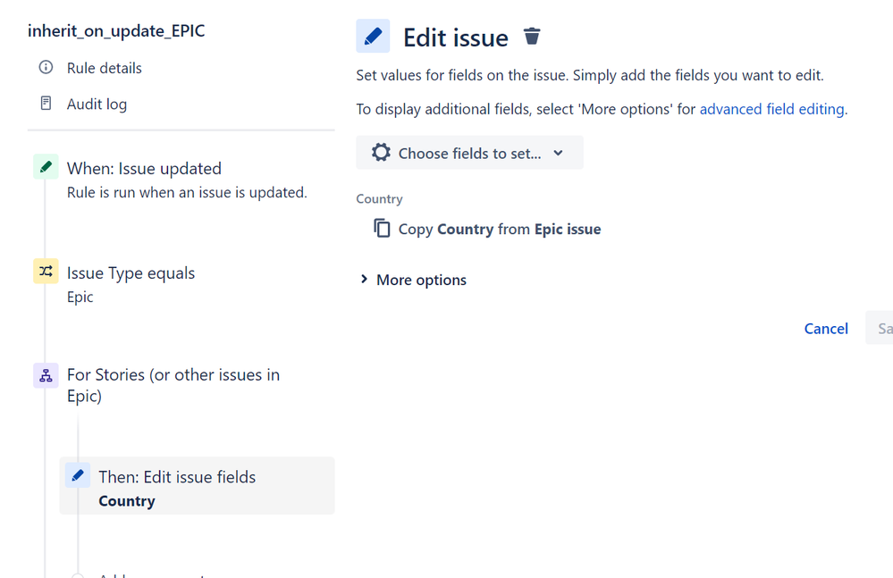

This example of an automation rule will always be triggered when an EPIC issue is updated. If this condition is fullfilled all stories/issues in the epic will be edited and inherit (in this case the value of the field "Country") from the EPIC (see screenshot)
There might be some further refinement of the trigger or fields or conditions but maybe this is something you could start with to then better investigate your special requirements while testing the rule.

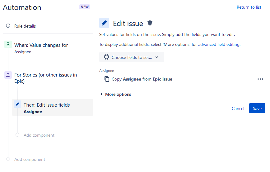

Example to Update Assignee on Epics children:
  • Go to Project Settings -> Automation -> Create Rule to create a project-specific rule or System Settings -> Global Automation -> Create Rule to create a Jira-wide rule.
  • There you can pick Field value changed as the Trigger and select all fields you want to keep updated.
  • Via New Branch -> Branch Rule /related Issues you can select on the Stories (or other Issues in Epic), such that the rule updates all children of your epic.
  • Finally, the action Edit issue lets you copy field values from the epic parent to fields in the children.
The result (for the Assignee field example should look like this:)

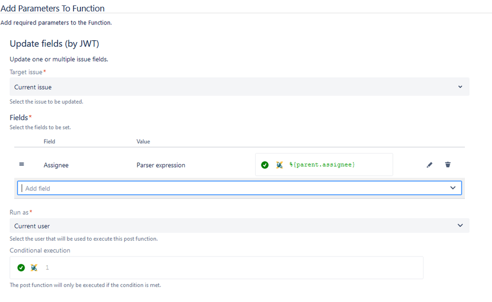

2) Leverage an app (e.g. Jira Workflow Toolbox)
The Alternative would be to leverage an App for this and trigger the updates (manually) with a post-function. For example with the App Jira Workflow Toolbox you can do the following.
  • Add a Transition All -> All to your Stories/Task workflow, called e.g. "Fetch Info from Epic".
  • Add the JWT Post-Function Update fields (by JWT)
  • Add the field(s) you want to change to the list and select "Parser Expression" as value
  • In the Parser you can select the correct field from the "Add field" menu. Just remember to select "from parent issue".
If you add this post-function to the Create-Transition of your workflow as well, the story/task will also be initialized correctly from the beginning.

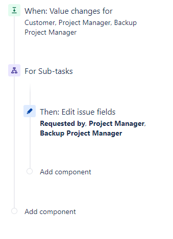

Maximilian Köhler
September 22, 2022
I did just that as you can see here
I tried doing the same but in the same rule as for the "Stories", made no difference. I am also wondering which issue I should copy for the sub-tasks, I think I have tried all variations but the sub-tasks never update when I change values in the Epic.

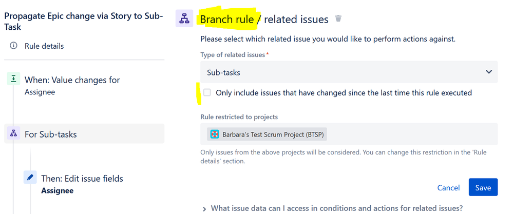

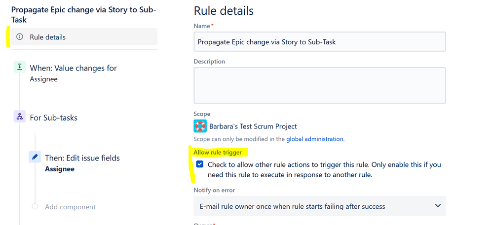

Barbara Schwarzwald _Decadis AG_
September 23, 2022
Hi @Maximilian Köhler ,
i think I have an idea, what could be the issue.
If I understand correctly, you have two rules. One rule as above, that updates the story from the epic and a second one that's supposed to copy from the story level to the sub-tasks below. The first one works, the second doesn't.
This is probably because (by default) rules don't trigger each other. This is to avoid infinite loops or performance issues in general.
You can skip this precaution in a specific rule under rule details and have it triggered by other rules: Let rule be triggered.PNG
Let me know if this solves your issue.
If your problem is instead, that some but not all issues are updated, make sure, that you did not accidently check "Only include issues that have changed since the last time this rule executed" in the Branch options:
Hope this helps,
Barbara

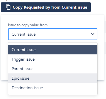

Maximilian Köhler
September 23, 2022
Edit2: So once I unchecked "Only include issues that have changed since the last time this rule executed" for the subtask rule it works.
Edit: Now suddenly it doesn't work anymore, I have to do some more troubleshooting.
Hi @Barbara Schwarzwald _Decadis AG_ I kept everything the same, except I did as you said and allowed the substask rule to be triggered by another rule. Also in the subtask rule I set the "Edit Issue" to "Copy FIELD from Trigger Issue", copying from any other Issue doesn't work.
