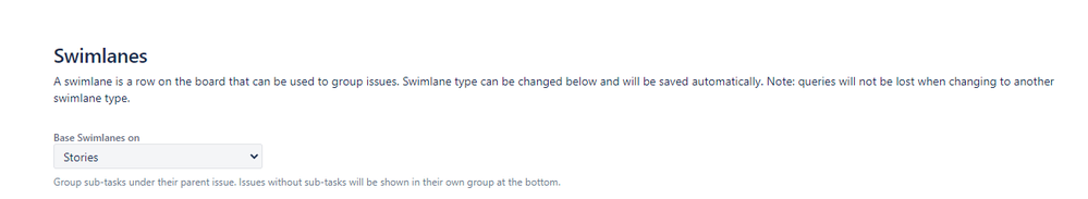

2)  Swimlanes area.  You'll get different results depending on which setting you use here.  Try changing this to Queries and see if that fixes it for you.

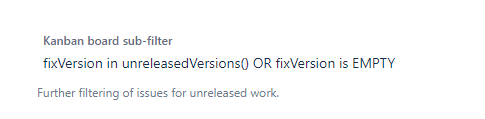

Can you paste the whole query here? I don't need the names or real project keys, but I do want to see how your query is structured as a whole. In theory, you don't need to specify issuetype in the main query at all - you could use the subfilter to remove the ones you don't want to see.
It's also possible that the sub-filter has this (default) which may be further messing with your board.

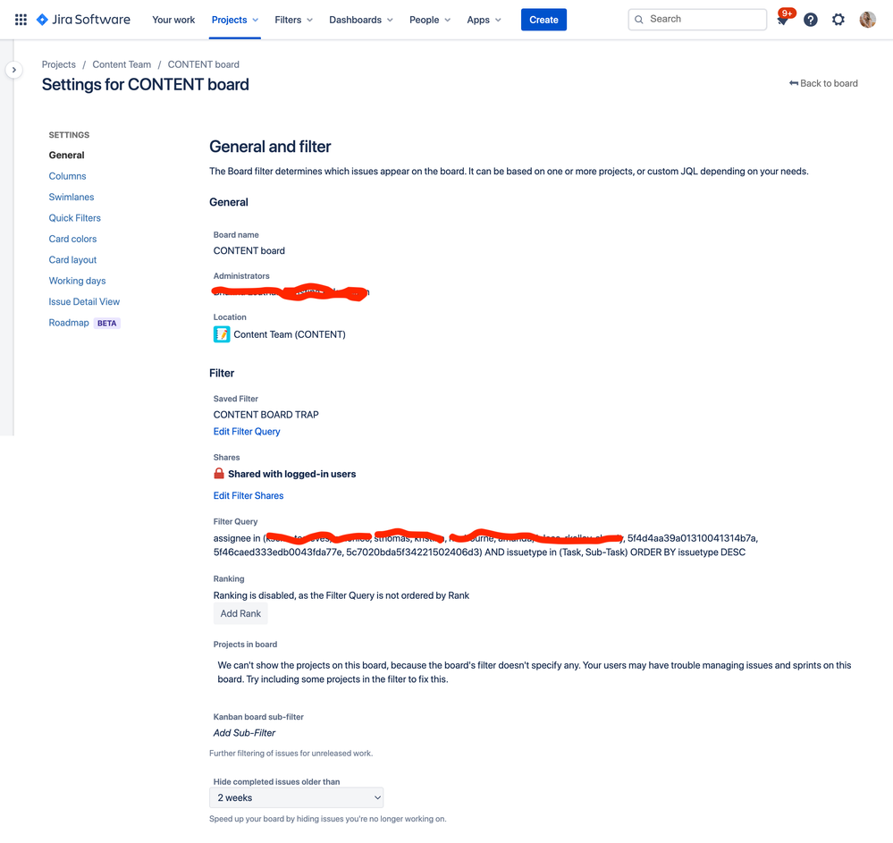

OK, if that is the full query - then my hunch is it is the sub-filter causing the problem. It's found in the General settings tab of the board settings, at the bottom.
Since you're looking for results specifically based on assignee, also try selecting "Assignees" instead of query (or others) for the swimlanes settings.
Emily Thraen
October 22, 2020
Removing the sub-filter did not work. I tried it with query, assignee, and story swimlanes.

If it still is not working, please consider posting an image of the board and of the board's General settings so the community can ponder this further.  Thanks!

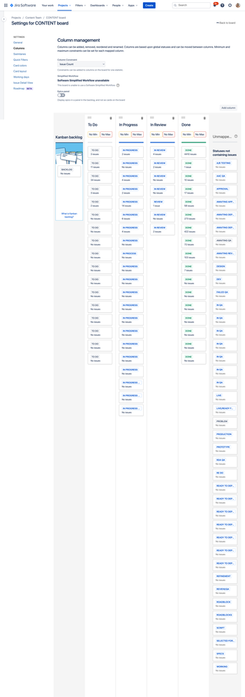

Would you please also post an image of the columns layout?  I am interested if there are any status values which have issues, and which are not mapped.

The column view is attached below. Unmapped status are from retired boards/ only used by DEV. No product utilizes stories currently.
