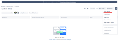

It's actually fairly easy to disable the backlog again within a Kanban board.  First click the elipses on your board, then go to "Board Settings."

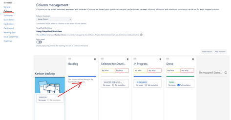

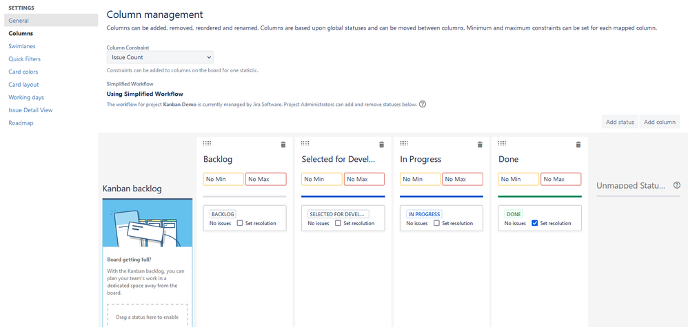

Once there, go to Columns on the left hand sidebar, and remove the status from the "Kanban Backlog" space on the far left and place it into another column.

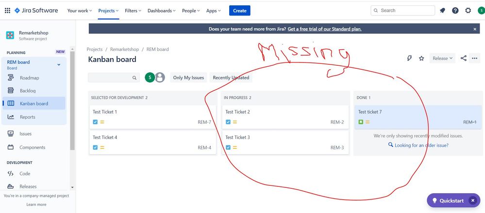

Hi Rodney thanks for the reply, but that isn't what I want to do.  My issue is that on the Backlog screen I only see Tickets in the 'Selected for Development' column.  I want to see all the tickets on the board in the Backlog Screen.
I attached two screenshots; as you can see Test Ticket 2, 3, 7 are missing from the Backlog screen and it only shows Ticket 1 and 4.  I want to see all the tickets on the board in Backlog screen.  How can I make this happen?
