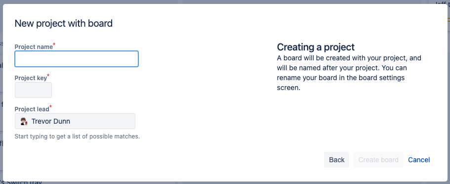

I agree with all that. Here is a screen recording of the flow I'm talking about:
https://drive.google.com/file/d/1VQKTFAI46p8MN8e7T93Jt9EN0QJQC4t2/view?usp=sharing
As you can see, there is no checkbox in this dialog (which creates a project) to share settings with an existing project. Frustrating! Cause it creates a bunch of redundant schemes that I don't want.

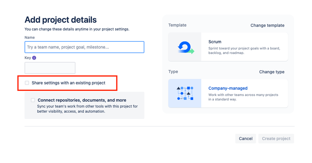

BUT, when you create projects from the other flow that I assume most are familiar with (/jira/projects) you get this screen which has a handy checkbox for sharing settings with an existing project:
Does that make more sense?
