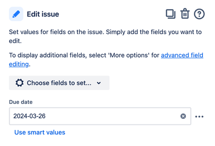

There is something strange about your question. If you want to set a fixed date, you don't need to use smart values, you can just specify the date in the due date field in your automation rule:
But that would not make much sense as a requirement, wouldn't it? You would be entering the same due date every time. So something tells me you do need something dynamic after all. What am I missing here?

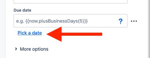

Hello @victor_kuzmychov
Why not use the Pick A Date option?
