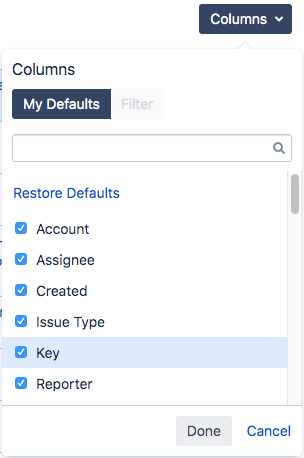

We just had this issue trying to configure a filter of issues and "Key" allowed us to display the issue numbers (ABC-1234) in a column. This needs to be set in the Columns setting on the right.
