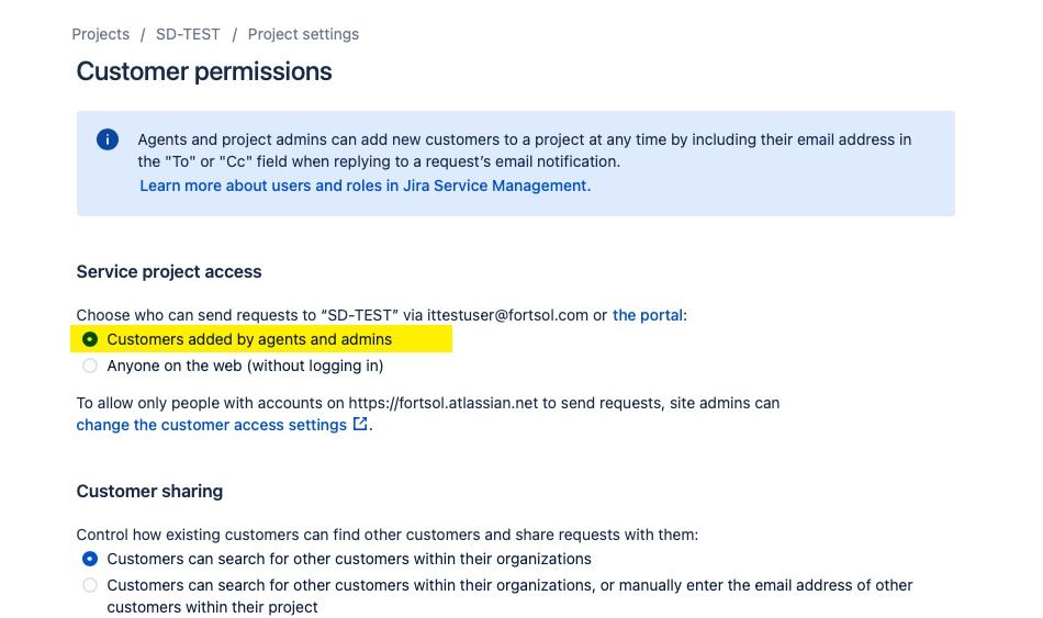

We have spam coming through and creating tickets.. I would like to only allow existing or manually added customers to be allowed to create the tickets. Is there a way to filter this? allow/block list is not a good solution since 'allow list' just makes sure the emails go through but it doesn't reject the rest.
Please let me know what your solution is and I will test it out!
Thank you so much
Jack Brickey
May 3, 2022
You should configure your project with customer permissions as illustrated below. Any email request sent to your project's email channel from an address that is not a current customer will be denied.
